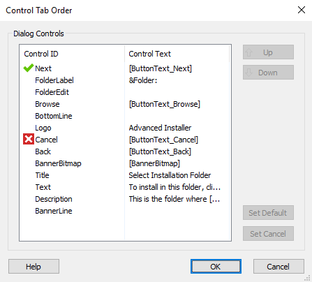

Control Tab Order DialogThis dialog allows you to change the tab order for controls on the dialog.
Dialog Controls
This list contains all the controls that are on the dialog. The order of the controls in the list represents the order in which the controls were created. Also this order gives the tab order of the dialog at run-time as well as the Z-order. Use the [ Up ] and [ Down ] buttons to modify this order. If two controls overlap will be visible the one who is lower in the list.
Set Default
Make the current control the default control of the dialog. By default this control is focused.
ImportantThe Default control must be a push button.
Set Cancel
Make the current control the Cancel control of the dialog.
ImportantThe Cancel control must be a push button.
NoteA control can be simultaneously Default Control and Cancel Control for a dialog.
