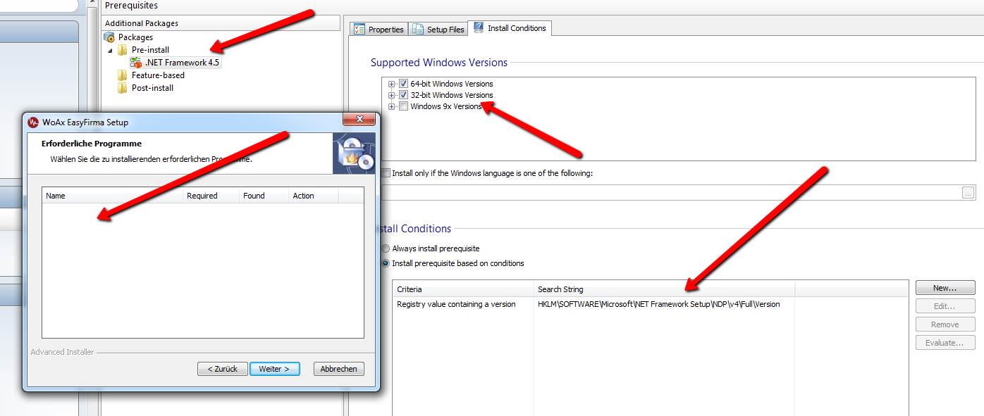

ifoko
Posts: 35
Joined: Tue Apr 12, 2011 5:10 pm
Re: Do not show empty prequiste window
I did what you said, but same result. see picuture.
I am making something wrong?

Bogdan
Posts: 2794
The settings look to be correct. Have you done this in a new project or is this the older project of Advanced Installer that you mentioned above? Can you please send me the that project?
EDIT
I had a looked over your screenshot and also the project you sent me by e-mail. Please note that you have a pre-install prerequisites. This type of prerequisite is installed before the main MSI is launched.
The predefined "PrerequisitesDlg" dialog that we provide lists, and is affected, only by feature-based and post-install prerequisites. Since you have only a pre-install prerequisite you should delete it from the
project entirely, from Dialogs page. For the pre-install prerequisite we already provide a predefined dialog that appears only if the prerequisite is not already installed, before the main installation starts.
