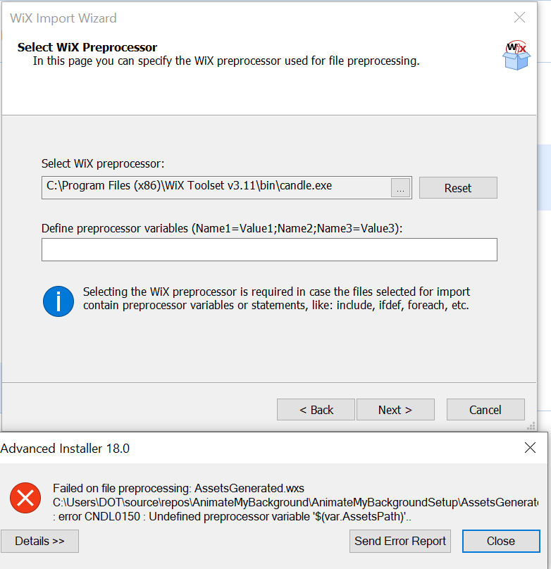

Hi, I have just recently purchased Advanced Installer and trying to convert a WIX installer project but I am running into problems, first I have tried it through the AI program and it produces an error at the Select WIX Preprocessor dialog.
I am new and don't have much coding skills and don't no much about WIX other then tutorials and such please be gentle on me, as you can see when I click next it produces an error, I dont know what the define preprocessor variables are or how to use them...

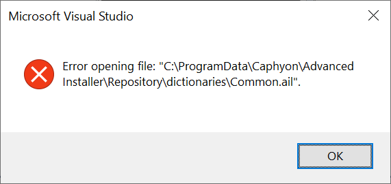

So I have tried to convert my project through Visual Studios 2019 and I get this error,
I have looked in the folder specified ...Advanced Installer\Repository\ but their is no folder called \dictionaries\

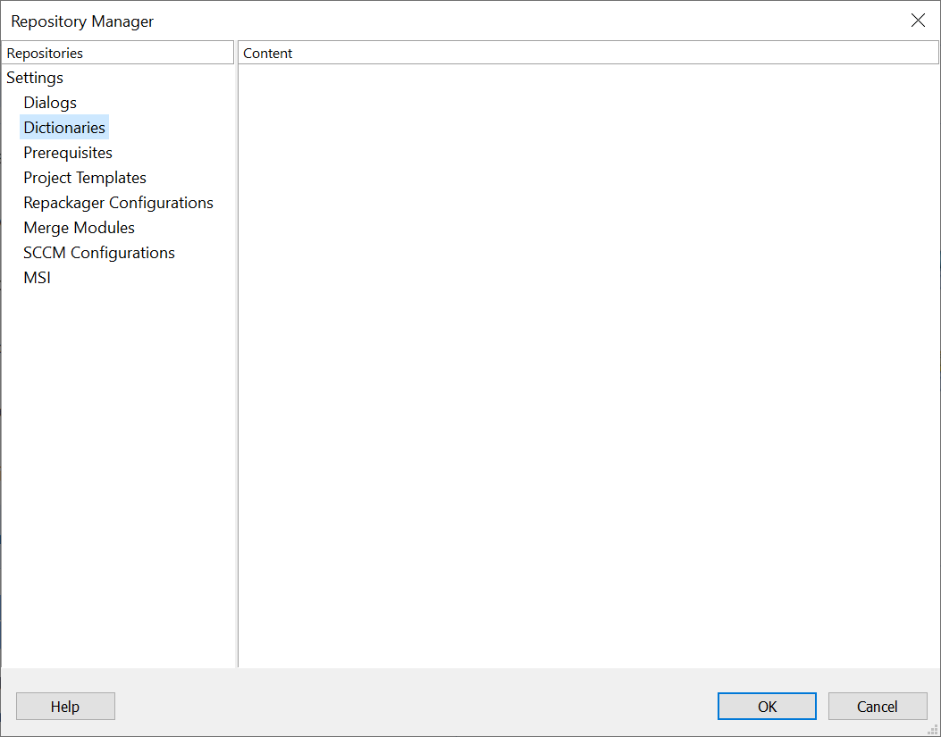

In the AI app I have looked in the repository manager but under each folder their is no content?
How do I add content here? and will it fix the problem? also I am running the professional version of AI or at least I think it is as that what I payed for and then just logged in instead of adding key. Any help on this matter would be greatly appreciated,

I am not so sure why the WiX project import fails, but the quickest way to get your setup project created should be through our Visual Studio extension.
Can you please send us your VS solution (SLN file) and all of the project files it includes (only the project definition files without the source code files) by email at support at advancedinstaller dot com so we can investigate them? Also, if you could give us a short step by step test case you follow until you reach the "Error opening file" ...\Common.ail" error, this will be great.

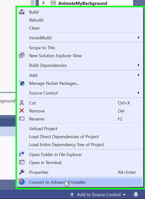

here are the steps I have done to try this In visual studios
1. open project in visual studios.
2. right click on WIX project.
3. click convert project to Advanced Installer.
4. Error message appears the moment I click convert project.
the files you talk about ? the definition files not sure witch ones you refer to as this is a C# project I would assume all of it is source? as stated in my previous post I am newish to all this lol, I can send the SNL file but I am unsure what other files you would like to Include... is it the WIX project files?
