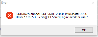

Thanks for your response, I decided that I will bring the driver as pre-install, but now I have a different issue:
If I use a trusted connection with SQL Server driver and use default database dialog settings I have no issues to login with Windows integrated user when clicking on test connection, and also if i use SQL user i have no issues
but if I change the driver and use the same dialog for SQL database (only driver is changed in corresponding actions) when I click test connection with Windows integrated user I receive an error: Login failed, but if I use SQL user it's ok.
In the first case when using SQL server driver I did not use any code for managing login with Windows user and SQL user this was handled no matter how the user is logged if a user is valid authentication is ok (it was working out of the box), but now with the new driver there are issues when login with user windows trusted authentication and SQL user and I guess now I need to handle this?
I have attached two samples of .aip files, just build and try to log in with windows authentication and you can notice the difference.
is there something that I missed when another driver is used from the default SQL server or I will need to manage windows authentication also?

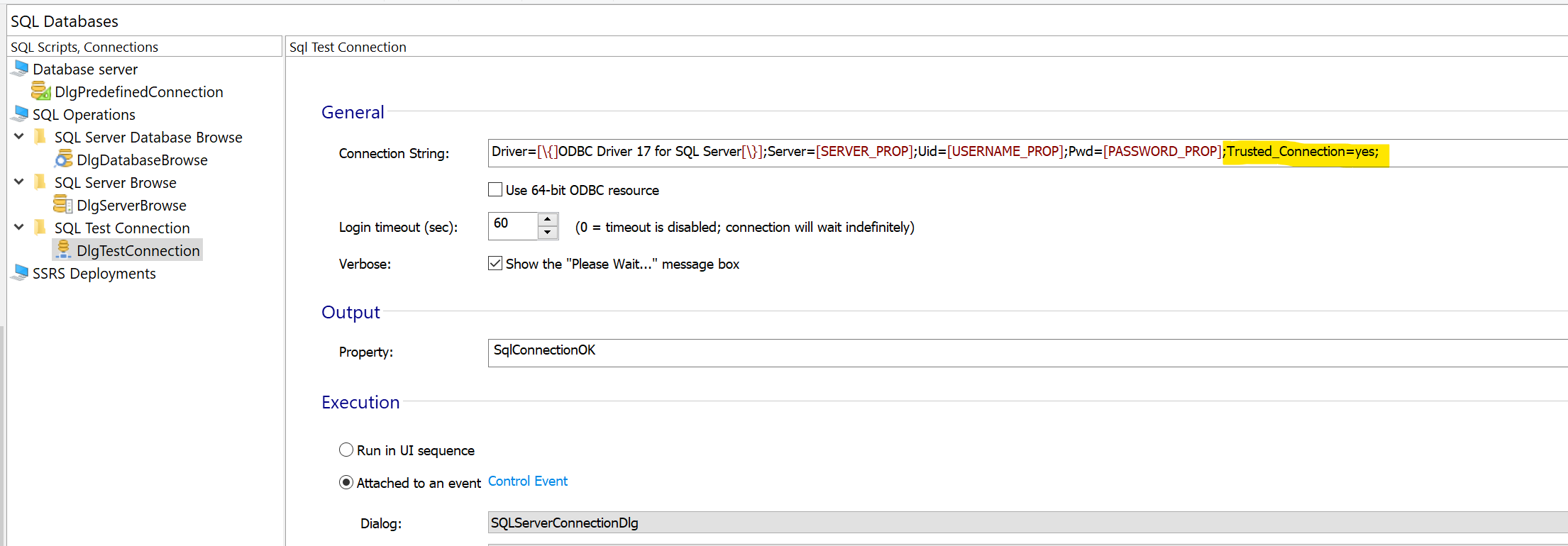

You need to add the parameter Trusted_Connection=yes; in the connection string:
  • Driver=[\{]ODBC Driver 17 for SQL Server[\}];Server=[SERVER_PROP];Uid=[USERNAME_PROP];Pwd=[PASSWORD_PROP];Trusted_Connection=yes;
The explanation is that the default value of Trusted Connection is "no" in the Server authentication mode when using this connection.
When false (no), User ID and Password are specified in the connection. When true, the current Windows account credentials are used for authentication.
"Trusted_Connection=Yes" specifies that a user account is used to establish this connection.

Hi Liviu,
Thanks for your response and explanation, it's working. I have attached a sample of how it's resolved.
Regards
