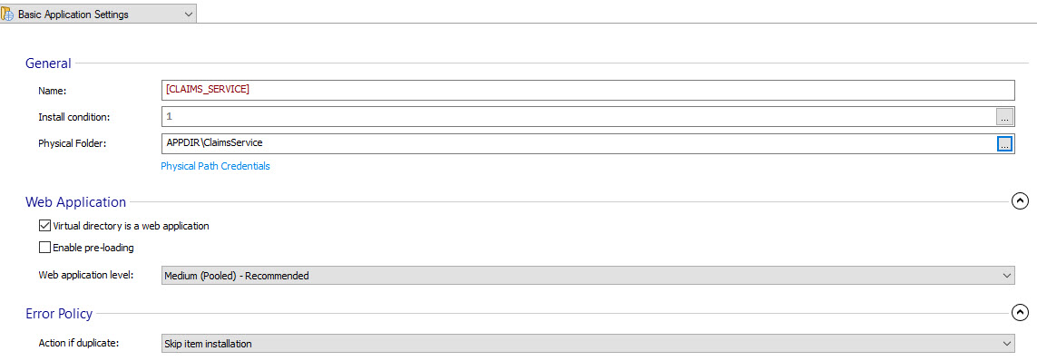

You are correct, general request is to have an ability to install dynamic list of services and configure appropriate Web Apps & App Pools for them.
I want to build a generic *.aip file that can be used for a multiple Web services installation, by passing some list of services to install to AI.
I was looking at either Power Shell COM functionality or Advanced Installer UI to achieve what I need.
Seems that AI UI for creating Web Apps expects user to select a path to a folder:
31-12-2021 12-15-18 PM.jpg (68.44 KiB) Viewed 34442 times
The "Main" Web Site already exists under IIS as well as "main" App Pool. I see there is a feature that may skip the installation of Web Site if it already exists (check by name).

Yes, in case the web site already exists you should use our "Skip item installation" error policy.
