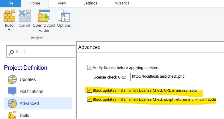

Now in what regards rejecting the updates when your license check server is not accessible or it returns an unknown return code, to achieve this behavior please proceed like this:
1. open your updates configuration project and go to "Advanced " page
2. make sure you check the "Block updates install when License Check URL is unreachable" and "Block updates install when License Check script returns a unknown code" options
Screenshot 2022-02-02 172503.jpg (53.19 KiB) Viewed 60054 times
3. rebuild your updates setup project and host the updates config file on your web server again
Let me know how this works for you.
