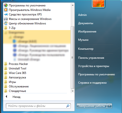

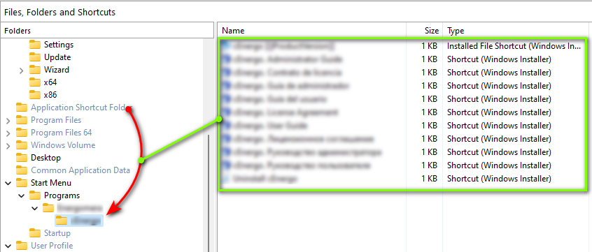

Hello.
I had a problem that I didn't notice right away. Shortcuts are created correctly on the desktop.
But shortcuts are not created in the start menu after updating from 18.8 to 19.0
I have customized shortcuts in the “Application Shortcut Folder” section. And it created shortcuts when installed in the start menu.
In the form of "Organization" - "Applications name" - "List of shortcuts".
Worked on Windows 7-10. When use in version 18.8
After updating the Advanced Installer from 18.8 to 19.0, shortcuts were no longer created in the start menu and in Windows 7 and 10.
This turned out to be a surprise, because the changelog does not say anything about this.
Could this be a mistake? Please fix or suggest what has changed.

In addition. I am using conditions to create shortcuts.
As discussed in this thread - Shortcut and files depending on the language
For three languages, Russian (ProductLanguage = 1049), Spanish (ProductLanguage = 3082) and English (ProductLanguage <> 1049 AND ProductLanguage <> 3082).
Checked so far only on the Russian system locale. But I think others will have the same problem.

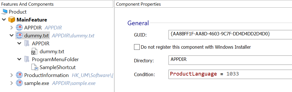

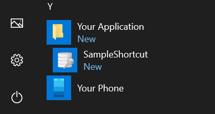

Posts: 7492
Re: Shortcuts are not created in the start menu after updating from 18.8 to 19.0
I have tested this scenario and the shortcut was created on my Windows 10 machine, as per attached screenshots:
If possible, could you please create a sample project that reproduces this and forward it to me by email at support at advancedinstaller dot com? Here would be the files I need:
- the sample project (the .AIP file)
- the files needed so I can build the .AIP file (e.g. a random executable and the dummy file)

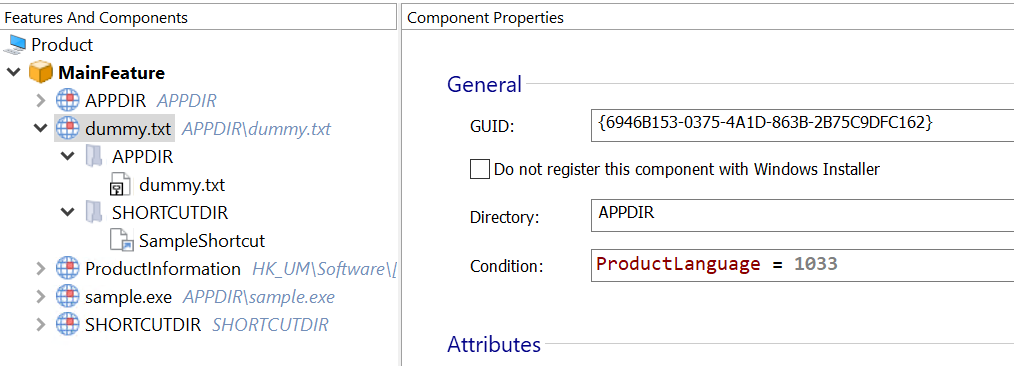

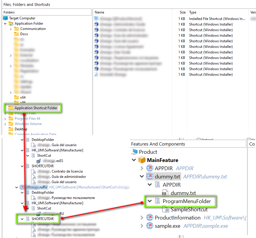

AKR
Posts: 29
Joined: Tue Jan 22, 2013 1:31 pm
You tried not exactly the same scenario as mine. Please try to do as in the first picture.
I have shortcuts in the “Application Shortcut Folder” section. And so everything worked in 18.8 and does not work since version 19.0
I have a SHORTCUTDIR and you have a ProgramMenuFolder, see the picture from my second post and yours.

Posts: 7492
You mentioned that shortcuts were not created in the Start Menu so I assumed you were talking about the "ProgramMenu" folder. Sorry for that.
Now, I have retested this as per your instructions and I still am not able to reproduce the issue. The shortcut is created as expected.
If possible, please create a sample project and forward it to me by email at support at advancedinstaller dot com so I can test and investigate it.

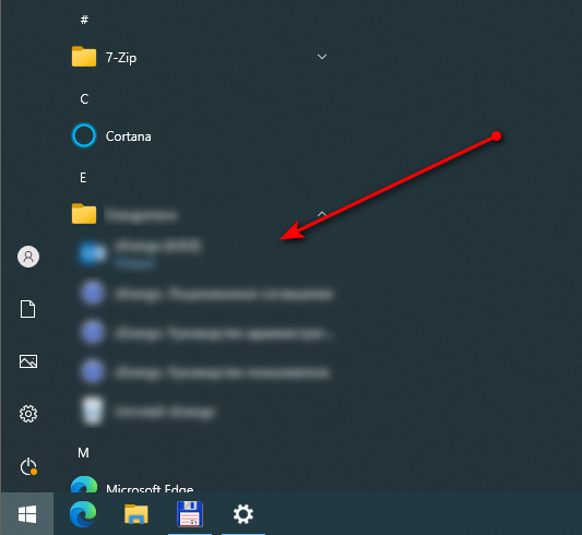

AKR
Posts: 29
It is not possible to create a demo project or send a working project in which the problem exists.
I just moved the shortcuts from the “Application Shortcut Folder” to the “Start Menu - Programs”, and creating the necessary group "Organization-Application Name".
That got around the problem. This worked for Win7 and Win10.

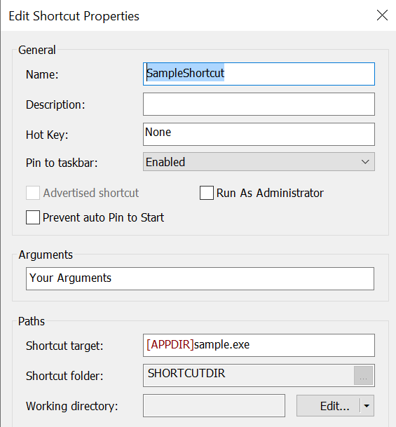

LaughingJohn
Posts: 39
Joined: Wed Aug 11, 2010 1:05 pm
I just wanted to jump on and say I had the exact same issue after upgrading to 19.2. I've downgraded to 18.9.1 and it's working again. There's definitely something going on here.
I've attached an image of my shortcut (I also tried recreating it). It's just a shortcut to the main app in the package. It had squiggly red lines under the prop name in the Shortcut target (which I couldn't edit), although that seems to be the case in both 19.2 & 18.9.1 so it might not be related.
My project is in a Visual Studio solution although I doubt that is relevant.
See attached image.
