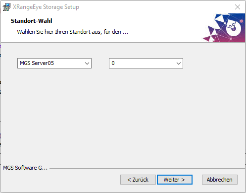

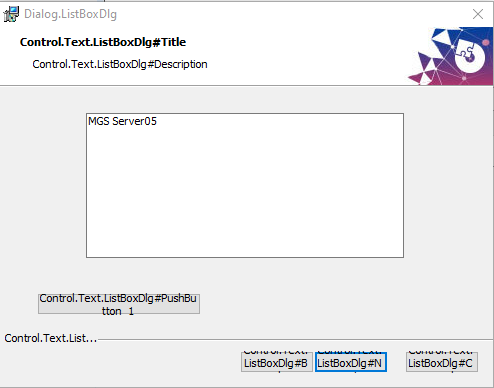

So far I have succeeded in connecting sql query with combo box. And I have each ID and DESCRIPTION lists in two different COMBO BOX. The problem is that when I wanted to move these two lists into one LIST BOX, I only got the first item from the first COMBO BOX. And a problem with writing that appears inside all buttons as of ListBoxDlg.
attached the fotos.

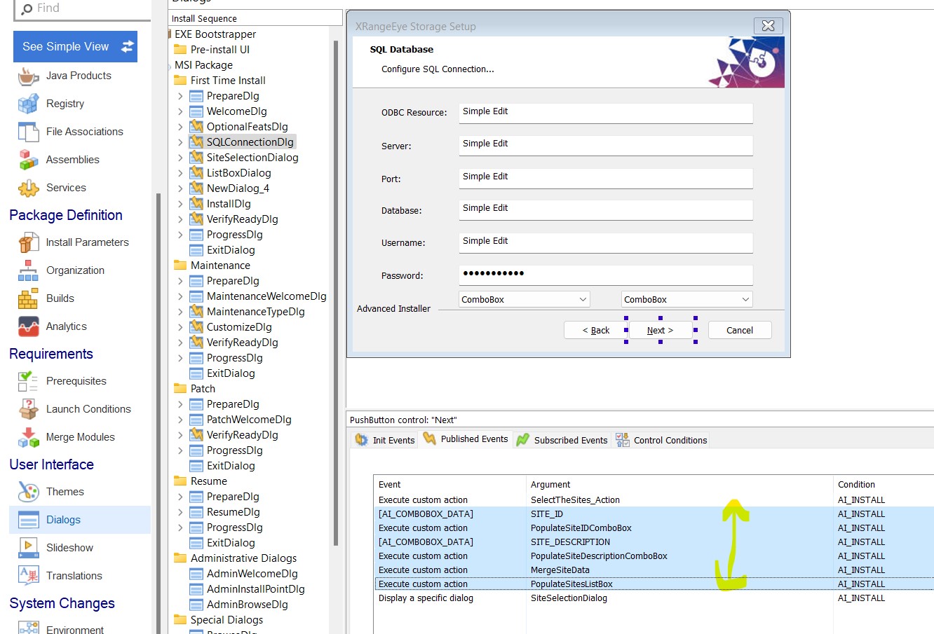

1. go to "Dialogs" page and select "Published Events" list on [Next>] button (on "SQLConnectionDlg" dialog)
2. delete all the below selected events

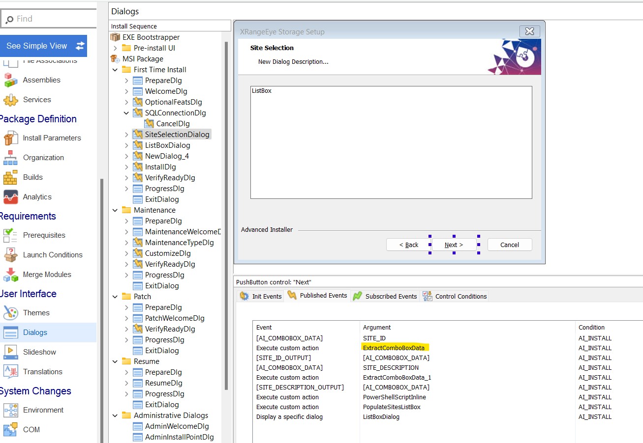

3. go to "SiteSelectionDialog" and select the "Published Events" list on [Next>] button; modify the second event to execute the "ExtractComboBoxData" action instead of the "ExtractListBoxData"
4. also delete the "Refresh the current dialog" event
5. go to "ListBoxDialog" and select the "Published Events" list on list box control; delete the "Refresh the current dialog" event
6. save and rebuild your setup project

Thanks for the help, so far I was able to get the required list in following your example that you sent :P .

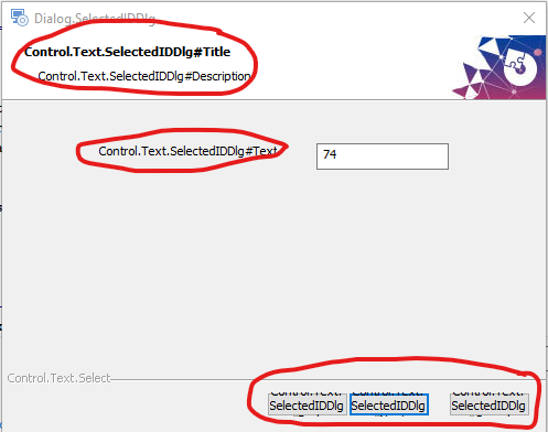

I just have a small problem that the writing in the buttons appears as in the screenshot.
Please help me to solve this problem. Notes that this appear in only one dialog. All other dialogs are normal.

This is actually caused by a small issue in our tool. Thank you for bringing this to our attention:
To get this working please proceed like this:
1. go to "Dialogs" page and select one of those controls (e.g. [Next] button
2. in the right pane click on the translation (flag icon) button
3. select the "Never translate" option and click [OK]
4. proceed the same for the rest of your misbehaving controls
5. save and rebuild your setup project

yes, that works. thank you very much.
