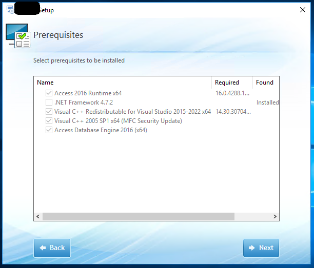

I have some prerequisites that need to be installed before the actual setup.
Unfortunately, there is no update of the UI during the installation. The AI window remains completely white.
Only after about 5 minutes after the installation of the prerequisites is complete does the welcome dialogue appear.
Is there a way to fix this?

I have tested this with a sample project and I can indeed confirm the behavior. The ProgressPrereqDlg dialog is not rendered as expected on Spring theme.
I have forwarded this to our development team and hopefully this will be fixed in a future version of Advanced Installer. As soon as the fix will be released we will notify you.
Unfortunately, for the moment I'm not aware of any workaround for this. You can just try changing the theme.

This has been fixed in version 20.1 of Advanced Installer, released on November 16th, 2022.
