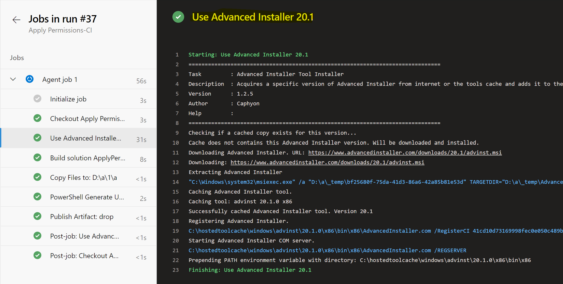

Can you please send us the .AIP (setup project) file and the "raw log" from the failed pipeline job, by email to support at advancedinstaller dot com so we can further test and investigate this?
raw log.png (87.41 KiB) Viewed 20512 times
