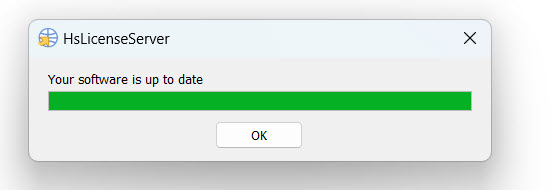

Here is an image of what I get with /checknow. How do I shut this dialog off so users don't have to see it and click it every time they boot?
Do you also use the -minuseractions here? Here is how the command would look:
/checknow -minuseractions
Do you call the updater like that?

I confirm that /checknow -minuseractions works. Thank you.
I had misread the argument and had used 'interactions' instead of 'actions'.
I had also entered '-minuseractions /checknow', putting the -min argument before the slash argument.
