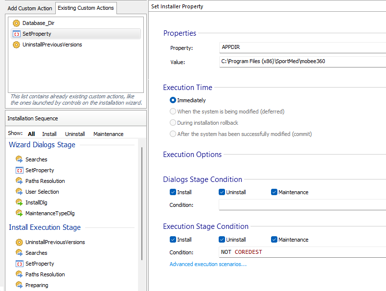

I have a lot of installer projects for our products. This is a plugin based product- a base installation and certain plugins that will install into the installation folder of the base installation. The base part is also a setup created with Advanced Installer and comes as a prerequisite with the plugin installer. The plugin installer starts, doesn't find the base part and launches the installer of the base. This is installed into a user defined folder and when the installation is finished, the plugin installer does a registry search for the installation folder via "Searches". A custom action of type set installer property is performed after "Searches" in Wizard Dialog Stage and also in Install Execution Stage which sets the APPDIR to the Value of the Search Property.

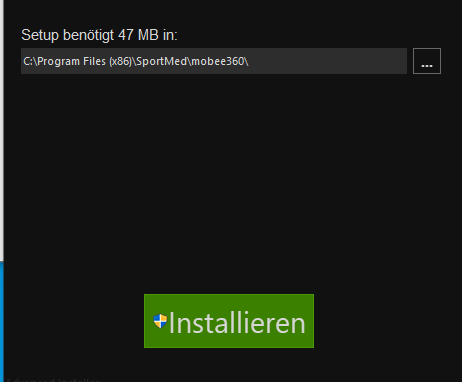

So here is the screenshot. This ist right after the plugin on the right called the base installer. I modified the installation path of the base installer to C:\Testinstall.
Installer start.png (30.57 KiB) Viewed 7661 times

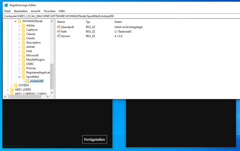

This is the registry befor the installation of the base part:
The base part installs and this is right after it's installation. You see, there is an entry in the registry:
Installer base end.png (47.6 KiB) Viewed 7661 times
Than the plugin installer gets back to work and this is the result of the Search -the path for the installation is the default value that I set, so the search was not successfull:

Here is the search:
And the custom Actions:
Custom Actions.png (42.86 KiB) Viewed 7661 times

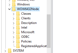

However, that does not seem to be the case here as the registry search should, in fact, be 32-bit - we can see that in the WOW6432Node entry.

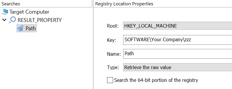

Now, here's how I tested this:
- created a new MSI called zzz.msi
- I added this as a prerequisite in a new project, scheduled to run "before the main package"
- in the "Search" page, I created the following search

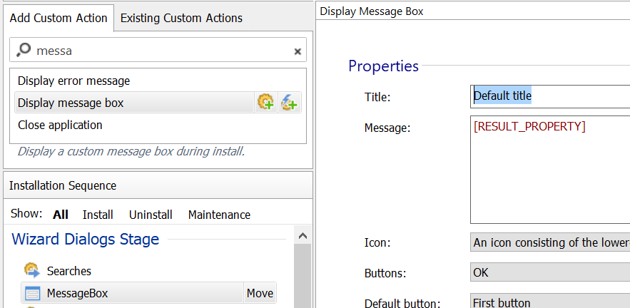

- in the Custom Actions page, I have added a messagebox to make sure this works as expected
Note: you can see that my search is set to "Retrieve the raw value".
Upon installation, the prerequisite is installed and then when the main package installs, the searches are executed and then the MessageBox prints the expected path:
