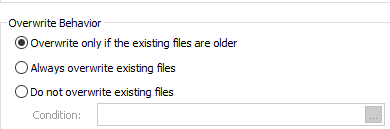

Normally, the backup is only done when this option is checked:
which in your case isn't.
You sent me the project empty, so I wasn't really able to test this. On your end, did you check what items the backup folder contains? Are those the exact same as in the DATA_DIRECTORY?

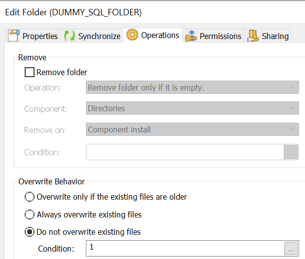

I have run the tests on my end and I was able to reproduce this as well. Upon further investigations, it looks like this happens because the DUMMY_SQL_FOLDER which has the option enabled:
Now, why this happens is because both DATA_DIR and DUMMY_SQL_FOLDER have the same path, C:\BTS.
jusher
