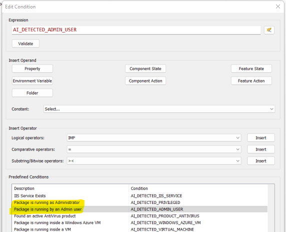

I have the "Per-machine if user is administrator, per user otherwise" and a scheduled task for the updater. Is there a way to ignore the scheduled task if the user is not an admin without showing the error message "an error was encountered while creating a scheduled task ..."?
Thank you in advance
Federica
Posts: 1325
Re: Access denied creating updater scheduled task
Hello Federica,
In order to achieve this, you can use condition the Scheduled Task creation.
Right click on your scheduled task --> Properties --> Install condition option. Here you can add the AI_DETECTED_ADMIN_USER or AI_DETECTED_PRIVILEGED condition.
