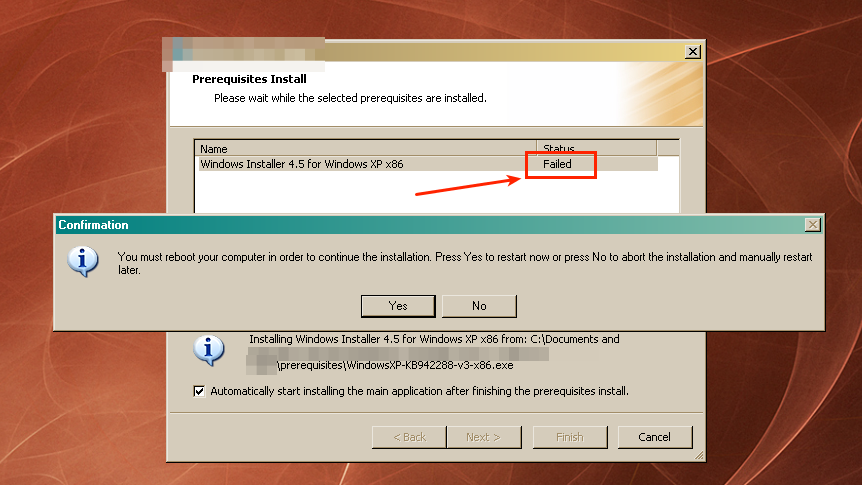

Hi, we are including the Windows Installer 4.5 prerequisite, for Windows XP x86.
We tried the /quiet install command line, but it does an automatic machine reboot, and we prefer that the user is advised of the reboot action.
So we are now using the /norestart /passive command lines, so the hotfix is installed visually, but without user input, and it does not reboot the machine; than in the prerequisite setting of Advanced Installer, we enabled the option "Reboot system after installing this prerequisite".
It works, as the hotfix is correctly installed without user interaction, and at the end the Setup ask the user to reboot the computer, but it show status Failed: a customer could understand that the hotfix was not installed correctly... Please see screenshot attached.
How can we avoid this?

I'm afraid this is the normal behavior. Please keep in mind that searches from "Prerequisites Install Condition tab" are performed twice:
- first to determine whether the prerequisite should be installed ( if the conditions are false)
- and second time, after the prerequisite has been installed, to determine whether the prerequisite install was successful ( when the conditions should be evaluated as true )
The reason you are getting this issue is because when your conditions were evaluated second time they failed, because the reboot wasn't performed.
So, in order to avoid this you can run the prerequisite package with /promptrestart command line parameter.
