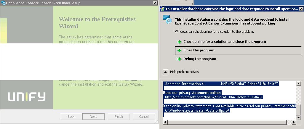

I updated AI from previous Version 10.7 to 10.8 and rebuild my setup. After that Prerequisites are crashing. Build with 10.7 was okay.
Problem signature:
Problem Event Name: APPCRASH
Application Name: OSCC-E Setup.exe
Application Version: 2.99.0.25
Application Timestamp: 52a6ee12
Fault Module Name: StackHash_f370
Fault Module Version: 0.0.0.0
Fault Module Timestamp: 00000000
Exception Code: c000041d
Exception Offset: 748e4f0d
OS Version: 6.1.7601.2.1.0.272.7
Locale ID: 1033
Additional Information 1: f370
Additional Information 2: f370279b62b9252bc90c49ea792daed1
Additional Information 3: 44d3
Additional Information 4: 44d34e5c349bd712abdb341fa17b4f27
Read our privacy statement online:
http://go.microsoft.com/fwlink/?linkid= ... cid=0x0409
If the online privacy statement is not available, please read our privacy statement offline:
C:\Windows\system32\en-US\erofflps.txt

I have found the error. Somehow when converting to 10.8 the .Net Framework 4.5 Prerequisite was doubled with a faulty entry. I have removed the faulty entry and the setup is working now.
