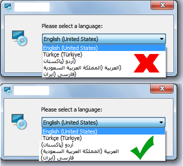

I have a problem with parenthesis direction in Arabic language in my multi language setup, here is a screen shot of my problem:
Is there a chance to fix this problem?

Sorry for the late answer, unfortunately I'm not sure how it should look in Arabic language, can you please help us with an idea?
Else, please give us some time to investigate this and we'll get back to you as soon as we have a conclusive answer.
Thank you for your patience and understanding.

I figured out that other Right-to-Left langs have the same problem for example: Urdu and Persian, I attached an image to show the right direction. Check it out.

Thank you very much for help, our team is already working to fix this problem and it will be available very soon.

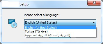

I have another problem in RTL languages... You can see it in this screen shot:
Posts: 4959
Re: Problem with parenthesis direction in Arabic language
Indeed, this is an Advanced Installer issue, a fix will be available in a future version. Thank you for bringing it in our attention.
This happens because the "Advanced Installer" text is drawn on the background image and this image is flipped at runtime for the RTL languages.
