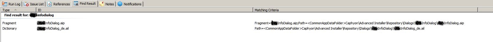

I did notice that even though the dialog was deleted from the project, a search for the dialog's name came up with two search results:
Solution:
Only after adding the dialog back to the project (from the repository - original dialog name) - and the rft text was then not showing - and then deleted it again, was the problem solved.
(Whew! I didn't make a backup for a few days)
Probably had I saved the dialog with the original name and reopened the project, it may have then been alright. I have a copy of the Aip where it still happens, and the original dialog in the repository is still there, so I can still test that if you wish.
