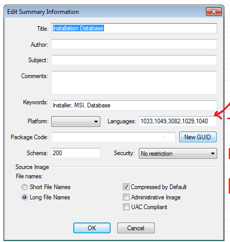

I have added 0 to LanguagesList:
But now there is validation error (Orca):
ICE39 ERROR PID_TEMPLATE value in Summary Information Stream is not valid. It must be of the form "Platform,Platform,...;LangID,LangID,...".

It seems this happens because in my previous reply I've added a space character in front of "0" from the "Template" field (i.e. ;1033,1040,1049,1029, 0). Can you please remove the space character within the "Template" value like this
;1033,1029,1040,1049,3082,0
and build again the project?
Also, I've updated my previous post with a valid "Template" value (without having a space character in it).
