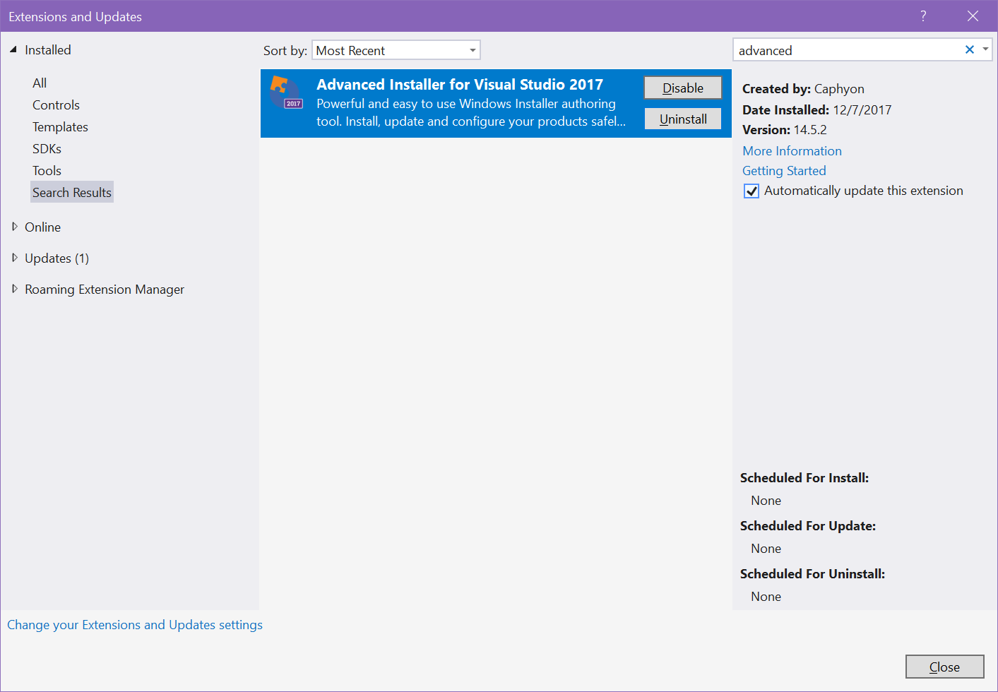

In order to disable the automatic updates for a Visual Studio extension, you can go to "Tools -> Extensions", select an installed extension and uncheck the "Automatically update this extension" option from the right as shown in the attached screenshot.
AI Extension.png (71.7 KiB) Viewed 20741 times
