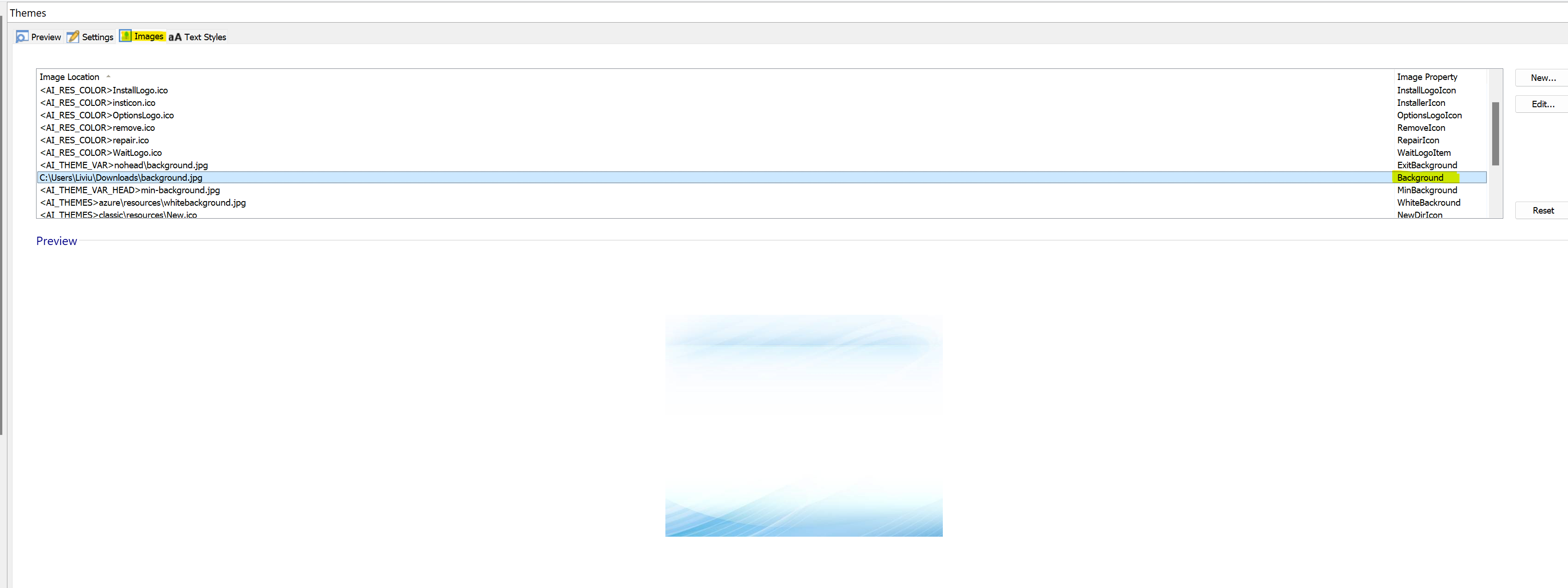

For the Azure Theme (LightSkyBlue variation in your case) the watermark text is added on the images which make up the frame, located in the following paths:
C:\Program Files (x86)\Caphyon\Advanced Installer 19.9\themes\azure\resources\variations\powderblue
You can edit the background.jpg images from the Head folder with a tool like Paint or Photoshop.
After that, you can go to the Themes page --> Images tab and replace the image for the Background property:
custom background.png (140.65 KiB) Viewed 3264 times
Now the setup looks like below:
You can also create your own background image and change it.

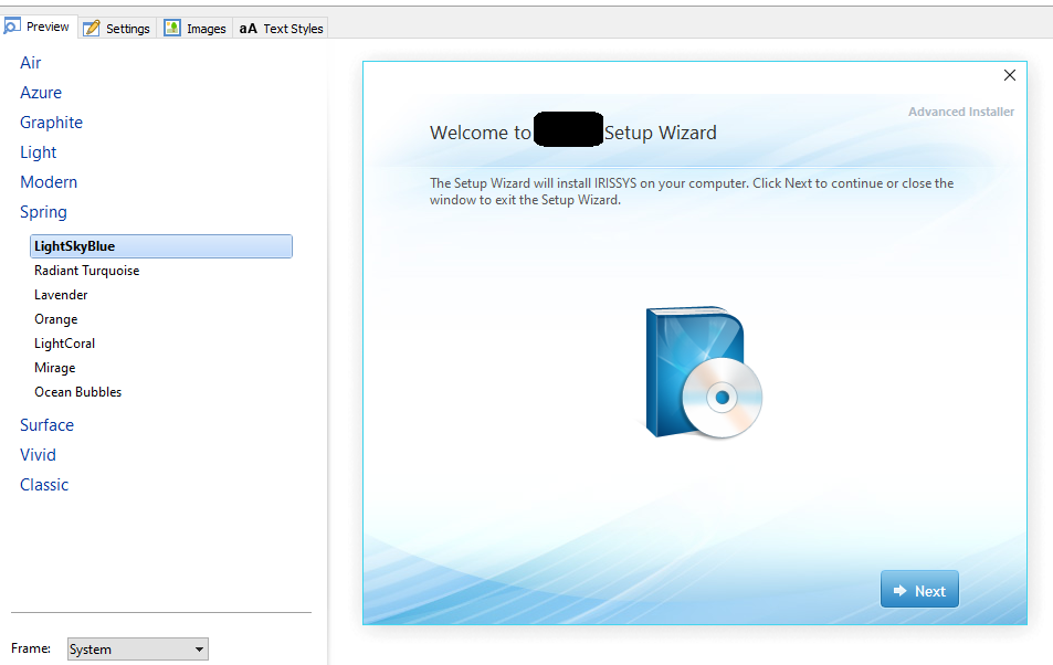

Unfortunately, this procedure does not work for the "Spring\LightSkyBlue" theme.
This is based on HTML. After a bit of searching, I came across the file "...\themes\spring\resources\html\common.js". This provided the JavaScript function "AdvinstTextMark()" which then enters the text on the HTML page.

Sorry for that, the Spring\LightSkyBlue theme is similar with Azure Theme\LightSkyBlue and somehow I overlooked this.
Yes, the Spring theme is developed using HTML.
On these dialogs we use an html control (TabHost) which contains the whole page in HTML.
