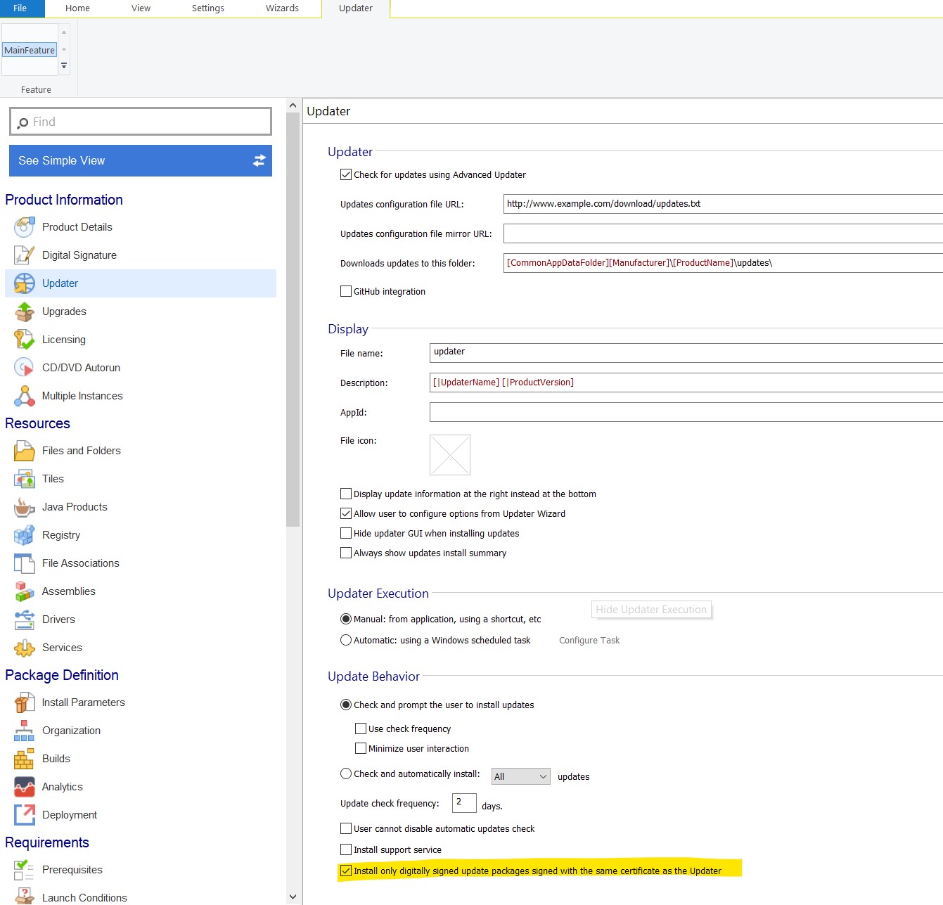

Hi and welcome to our forums,
If you use our Updater tool to check for and install updates packages, then you should check into your setup project (in "Updater" page) and see if you have the Install only digitally signed update packages signed with the same certificate as the Updater option checked.
If so, then you should request from the new certificate vendor that your new certificate is built and created using the same Subject as your old certificate.
Otherwise, if you do not use the above option, then there will be no limitations caused by a new certificate.
