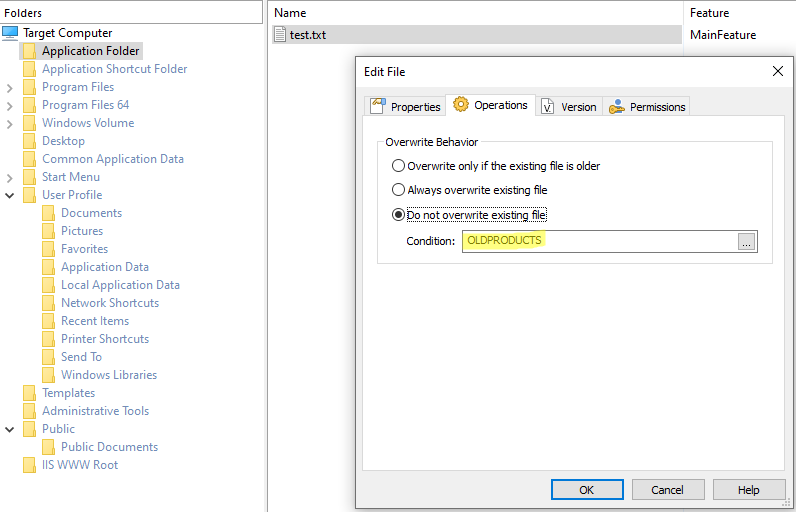

To preserve the old files from the previous installation, just follow these steps:
  1. In the newer version of your project, go to the "Files and Folders" page.
  2. Select the file you want to preserve, right click → Properties.
  3. From the "Operations" tab, check the "Do not overwrite existing file" option and on "Condition" add:
     OLDPRODUCTS
Let us know if this helped!

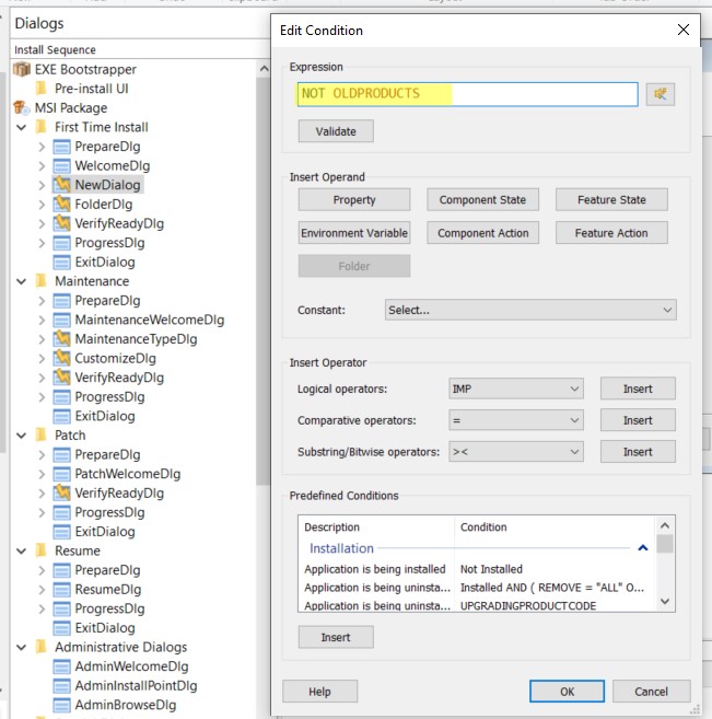

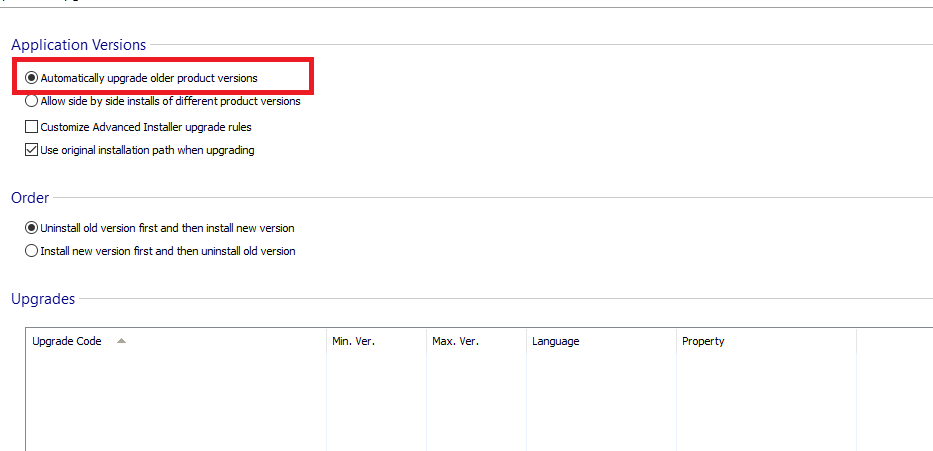

Re: Best way to preserve old configuration files and use in upgrade/update
Will be OLDPRODUCTS variable available/ fiiled if i use only Automatically upgrade older product version :
or i will need also do set customized advanced installer upgrade rules OLDPRODUCTS variable to be filled?
The idea is to preserve old configfile from the previous installation and when the upgrade is done if file is present just to skip all screens that asking for configurations, just installer simply change the rest of the files.

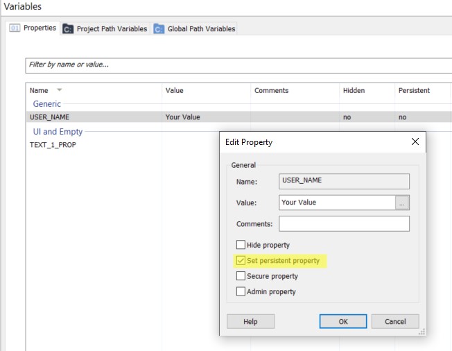

Advanced Installer offers you multiple ways to preserve the user settings:
1. If you have access to the first version of the setup project (i.e. you did not released its build yet) you can follow these steps:
- go to the "Properties" page, check the "Show properties with empty value or used in dialog controls" option.
- for each property that you want to save, right click and check the "Set persistent property". If you enable this option, the property is stored in the registry and available during the upgrade installation.

But now I have my other installer with features and also I will need to apply the same. Users can choose to install feature One of feature Two or Feature Three when doing an upgrade I will need to detect which feature is installed and to run upgrade only on that feature.
Also if I use to show only if on ConfigureDlg Not OLDPRODUTS when an old product is detected I can't choose which features to be upgraded maybe that is ok but the problem is what will happen if, for example, I have installed Only a feature one on this machine and then I try to upgrade I don't want other features to be installed I want only existing feature to be upgraded.
So not sure how to detect if the feature is installed in the previous version and how to disable a feature to be installed in a new version when doing an upgrade if ConfigureDlg is not shown, I was looking at this blog post https://www.advancedinstaller.com/foru ... hp?t=10740 but I have an error when adding upgrade action also not sure how to execute MsiQueryFeatureState ( i was also doing this on dialogs by Feature example)

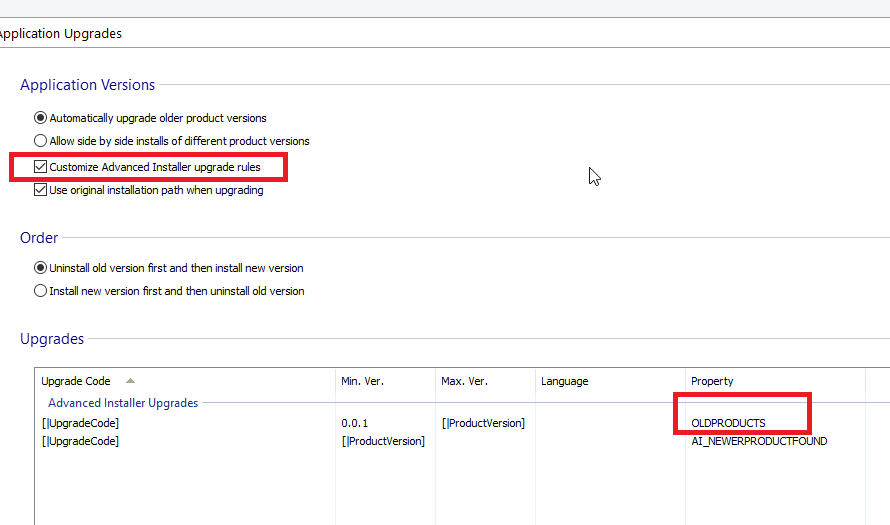

If you do not want to automatically migrate the feature and to conditionally install it in version 2, then you have to disable the “Enable Migrate Features action” option. But this is in contradiction with your previous request, first you wanted to automatically migrate the feature but now you do not want that, I’m a little bit confused.
The migration is happening due to the "MigrateFeatureState" action, whose purpose is to take the state of the features from the old package and transfer that to the new package.
In order to avoid this, please proceed as it follows:
  • In the newer version of your project:
    1. Go to the “Upgrades” page.
    2. Check the “Customize Advanced Installer upgrade rules” option from the “Application Versions” section.
    3. In the "Upgrades" table, double click on the upgrade code which has the property set to "OLDPRODUCTS".
    4. Select the “Upgrade Action” tab and uncheck the “Enable Migrate Features action” option.
    Now, if you install the version 2 you attached, then your FeatureB will not be installed since the condition is “TEST = 1”.
