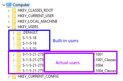

a bit of info regarding the registry to see if there is a way to do it within Advanced Installer
Registry values for users that are existing users on the machine.
Per User registry keys are typically edited in HKCU but in order to successfully apply any new registry keys on a new install to all users, the keys MUST be placed within their SID in HKU instead. HKCU is per user and looks into HKU per user. If the new registry keys are not placed in HKU, then each user when logged in will need to run the installer to add the registry keys.
Because there is an undisclosed amount of users, the HKU would need to search and find all users that not built in and the registry keys per user.
Registry values for users that are future users on the machine, not yet logged in are added
Obviously new or future users dont yet have an SID in HKU so we cant add any registry keys to them but, we can add the keys to the .Default hive. Windows uses this a template for new users. Can we access this in the Advanced Installer editor? The default hive would need to be loaded and the registry files added to it. Once aded, close the default hive. The default hive can be found at 'C:\users\default\ntuser.dat'
What needs to happen is a search of the SIDs in HKU that are not S-1-5-18, S-1-5-19, S-1-5-20 or .Default, and the registry values inside HKU .Default copied / added to them. Here is a batch code example that adds keys and values but id prefer if possible to all of this inside Advanced Installer.

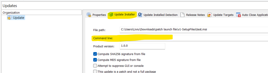

update = a simple progress bar showing the update
You can achieve this by launching the Updater with -reducedgui command-line switch - The Updater is launched with basic user interface (simple progress and error handling). Please check our Advanced Installer Updater tutorial.
You can also pass parameters to your update setup in the Updates Configuration Project:
For example, if you have an .EXE package you can use the /exebasicui switch which launches the EXE setup with basic UI.
For MSI package you can use the /passive command line - unattended mode (the installation shows only a progress bar).
Msiexec.exe Command Line
Proprietary command-line switches for the EXE Setup
When performing a Per User installation, the package must respect some rules:
  • it creates registry entries only under HKEY_CURRENT_USER
  • it creates shortcuts only in the user's profile (not in per-machine locations)
  • it writes information only in Per User locations (for example a normal user cannot write in the "Windows" or "Program Files" folders)
You can add registry keys for all users only when performing a Per-Machine installation. This is the default behavior of Windows Installer.
Note that HKEY_CURRENT_USER is used only for the user that installs the application.
If you want your application to be available for multiple users then you can add your registry entries under HKEY_LOCAL_MACHINE.

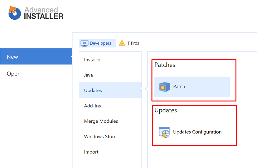

1. i would like to release periodic patches to fix very minor bugs
How do i create a patch and can i use the updater to automatically install them?
2. i would like to release periodic updates when i add or enhance features
Can i use the same update project for updates, upgrades & patches?
3. i would like to release milestone upgrades to a new version.
As above question 2
I would like to maintain a single update project that has all of the patches & updates for continuity.
How do i create a patch?
Can i select specific files to update? There is only 1 usually which is the exe project file

Patches can also be applied through the Auto Updater. Simply configure the patch as update, just like you configure a new version of the package. For the Updater it doesn't matter if the update is an MSI, EXE or MSP file.
More details about this in our articles:
1. Authoring a Windows Installer patch
In this article you also have a video tutorial.
2. Creating Patches
Advanced Installer supports two ways of updating an already installed application:
  • Upgrades
  • Patches
Unfortunately you can not use a single project for Upgrades and Patches. Each one has a different project type with different configurations:
A Windows patch package is an .MSP file that contains only the changes between the previous and the updated version of an application. It is used to install updated information such as files, registry, and configurations of an application that's already installed on a Windows operating system.
A patch is usually much smaller in size and it consists of the diffs between two packages (an MSI is basically a database). After diffing two MSIs (e.g. version 1.0.0 and 1.0.1) the changes will be saved into the patch file (MSP). At install time, the patch basically attaches to the already installed MSI, i.e.: version 1.0.0 is installed --> we apply the patch --> we obtain version 2.0.0. The Upgraded image is the new package that contains the additional files while the Target image is the original one.
If one of your packages is EXE and not MSI, you can use the "/extract" command to extract the MSI package from it and use it to create the patch.
You also need to make sure that your patch fulfills all the Patch Rules.
You can also check our What are .MSP files, how to create and extract them? article.

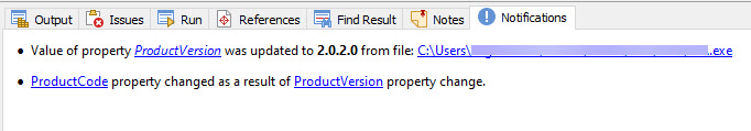

Im having a small issue creating a patch. Here is what i did-
in visual Studio
- I increment my project output to compile as V1.0.2 from V1.0.1
In my installer project
- i increased the product version from V1.0.1 to V1.0.2
- I kept the product code as the existing code
- I built the project
- Now i have 2 msi files, the V2.0.1 & V2.0.2
In the patch project
- I went to Images / New upgraded and selected V2.0.2.msi
- I went to Images / New Upgraded / New Target and selected V2.0.1.msi
- The difference between to the 2 builds exist as code changes in the V1.0.2.exe compiled from Visual Studio
- i went to build but got an error-
WARNING: Major patch. Providing a major upgrade as a patch package is not recommended because a major upgrade patch package cannot be sequenced with other updates
Question: Do the msi builds need to be different projects? I used a single build project with the updated product version.
and also
Usually, this error appears when you change the product code. This may also happen if you have different product names and component GUIDs.
I've already linked in the previous replies the articles you need to follow.
Please analyze carefully the patching rules.
If you still can't get this to work, please forward to me all your project files (the old/new .AIP projects and the Patch project) by email to support at advancedinstaller dot com.
and also

NigelShaw
Posts: 58
Joined: Wed Apr 01, 2015 12:45 am
Re: A few questions :)
Hey
Ive installed the Windows SDK so that issue should resolve. In terms of the issue of Product code, i didnt change that but it appears to have changed on its own. I changed the version code on the main .exe that is being installed (which is my project) but i didnt get the prompt offering to change or keep the product code. I see this in the notifications
The notification shows the ProductCode was changed as a result of ProductVersion property change.
Is there an automatic that needs to be turned off?
Am i doing the project exe correctly by up versioning the assembly version?
Posts: 1325
This behavior is caused by using the "File version from an EXE or DLL" option. When using this option to set the Product Version, at build or load time the ProductCode changes automatically, as you could see in the notification panel.
In your case, you should either stop using the version from file option or save the ProductCode and restore it after it has been automatically changed.
Posts: 7492
This has been fixed in version 20.7 of Advanced Installer, released on May 25th, 2023.
