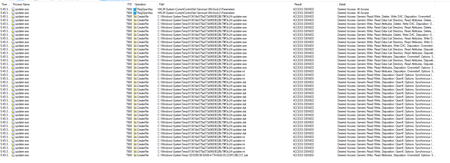

thank you Catalin. Setting the log works for normal user, but not for network service (no log is created, only aiu file.. Does this Process Monitor output give you any hints what might be the issue?

Posts: 7492
Re: Silent upgrade and SQL script Authentication
The screenshot, I'm afraid, does not give us many details.
However, it is quite clear that this is a permission issue, as we can see "ACCESS DENIED" for most processes.

well I filtered it only for ACCESS DENIED. I thought maybe the path that is being accessed is something that you know about, that the updater tries to write something to windows temp folder. Does that ring a bell?
Posts: 7492
Here's how the updater works:
- when you launch it, the first thing would be to download the INI file. This is required for our updater to scan its settings to see things such as the URL to the new package, the expected size, etc.
- after that, the updater will download the resources (e.g. MSI and, if the case, the CAB files) and will launch the MSI for installation
From the previous screenshot you provided, I can see that updater.ini is denied - this would be the updates configuration file which the updater downloads.
