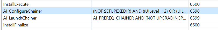

This is the reason why the setup is ran async and the action that launches the prerequisites happens right after InstallExecute action ends.
Note: you can see the above in the "Table Editor" --> "InstallExecutionStage" table (available starting in Enterprise suite).
