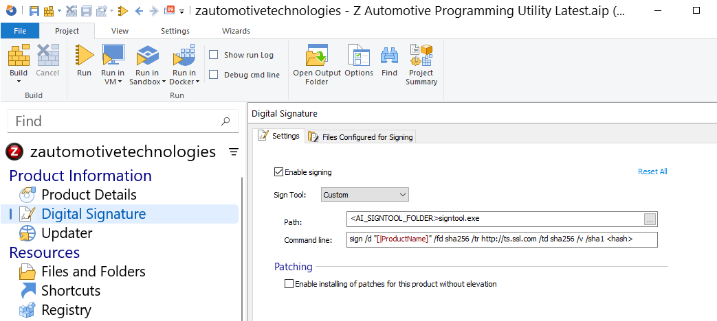

Just bumping this thread in hopes of finding a solution that addresses the need to enter a PIN hundreds of times when signing. Ideally, this would be natively supported in Advanced Installer, especially since hardware token-based code signing is becoming increasingly common.
For those unfamiliar with how we're currently signing with Advanced Installer and a YubiKey: we’re using the custom option shown below.
With the YubiKey plugged in before launching Advanced Installer (or by referencing the certificate’s SHA1 hash from the Windows Certificate Store):

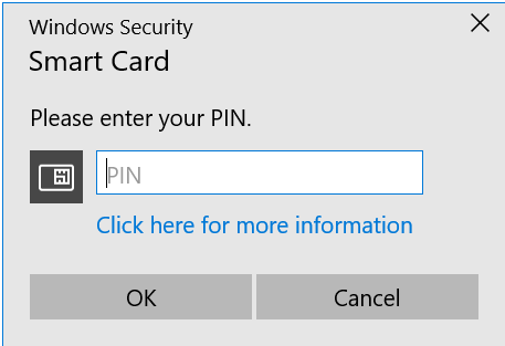

We’re then hit with repeated PIN prompts during the signing process:
This behavior makes large-scale signing incredibly tedious. We'd appreciate any insight or updates on native support for smart card-based signing in future releases.

Z Automotive wrote: Wed May 14, 2025 10:19 pm Hello,
