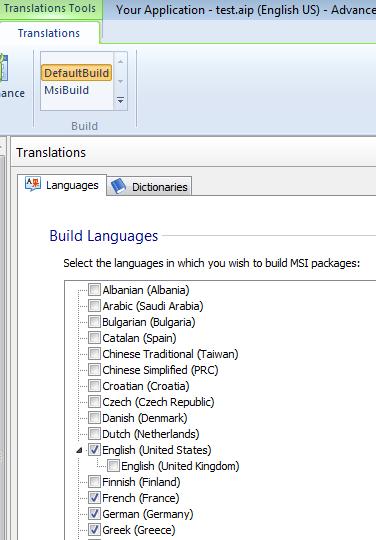

But still, if I want to create a multilingual package, I still need to open the project and I have to set the specific option by myself. Why is that so? Why is it not possible to set that value with the command line too?
By default, when adding a new language to the build, the "Create separate packages and a multilingual package" option is enabled.
Also, why is it nessecary, to add the buildname? You can't add specific languages to a specific build.
This is not true. Here's where you can select the build from the GUI:
More information can be found in the "Languages Tab" user guide reference.

Ok so far I did not require more than one build, otherwise I might have noticed that sooner.
But that discards only the reqirement do add the language to a speciffic build, not the fact that I must go through everey project, and switch the option to "Create only a Multilingual package".
If I had several builds, I'd still have to go through every projact and build.
I did use the command line to save time, and it saved me a lot of trouble and time to organize the projects. Maybe you can add an option in a future version, to set that option too with the command line.
But if there is a way to switch that option, using ONLY the command line, feel free to correct me. After all I'm still learning too ;)
