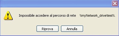

When I proceed to install the error appears:
Translation: Unable to access to network path
The curios thing is the last '\.' at the end of the string

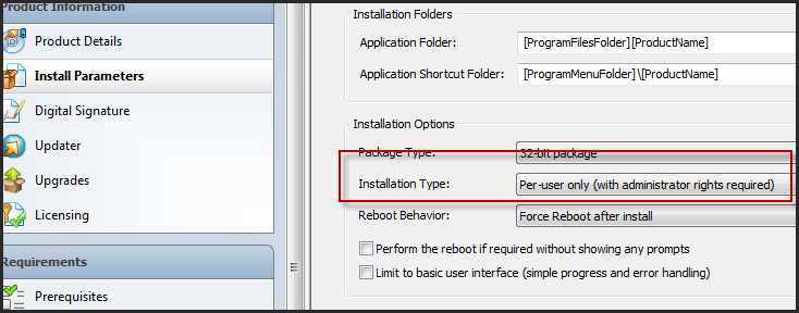

I'm not sure about Allplan settings, I'll ask it, but if I understand right, you are telling me if I set per-user I can access to network... I have already set this, my setup installation is showed in the screenshot
Maybe is the administrator rights required? So the setup works as administrator, and this user maybe cannot access to network. But if I set only per-user, without administrator rights, how can I write on ProgramFiles Folder? It can be written only with administrator rights with Windows UAC activated.
