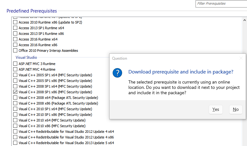

That being said, I did eventually find the Predefined Prerequisites section of the UI; (the only way I found them was by clicking on "Packages" tree item above "Main Package"). However, when I select the desired tree element, (Visual C++ 2008 SP1 x86 (MFC Security Update), what I get presented with a popup that says
This raises a few questions:
  1. I initially clicked yes, but did not then find the downloaded file in the same folder as my script; does this action happen immediately, at installer build time, or at install time?
  2. Is this being downloaded from Microsoft or Advanced Installer's site?
  3. If I clicked No here, then what happens?
  4. How would I select my own copy of the redistributable executable as the target?
(These are not merely academic questions; some of the installation sites will not have internet access, and so I need to ensure the installer to be self-contained, and would preferably not want to risk having that downloadable package go away at some point in the future, and so would prefer to have control here.)

Answers to my own questions:
  1. It turns out that happens immediately, but puts them in a subfolder called Prerequisites, which I missed on my first check.
  2. (I don't know, but I will trust that this isn't going away soon, but is hopefully less problematic, given (4) )
  3. I think that "No" means "do the download at install time", (which we don't want.)
  4. I was able to copy the downloaded prerequisite redistributable to overwrite my existing (older?) copy, and then point the "file from disk" option to that copy. (This was necessary to make the installer not think the install had failed after it tried to run the installer.)

Re: Prerequisite being incorrectly marked as "found"
Thank you for your followup on this! :)
Please allow me to answer your questions below:
The download folder of the prerequisites is defined in the "Prerequisites" page --> "Packages" --> "Global Prerequisites Options"
This is indeed correct - if you select No, the prerequisite will not be downloaded and embedded into your main installer, but rather added as a web based prerequisite and handled at install time.
