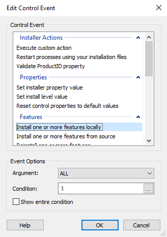

Edit Control Event DialogThis dialog allows you to edit a control event. A control event is an action that is triggered when the user interacts with the control.
Name
Select the desired control event from the list.
NoteThis list contains only the events supported by the selected control.
Arguments
Specify an argument for the condition. For some events there is a list of arguments from which you can choose, for others this field is of Formatted Type. Use the [ ... ] button to display the Edit Formatted Type Dialog that will allow you to insert a reference to a property. Also some events may not need arguments.
Condition
Specify an execution condition for the control event. Use the [ ... ] to show the Edit Condition Dialog which will allow you to edit a condition.
The control events created in Advanced Installer can use these predefined conditions:
  • 1 - this condition is always true; usually it's used by control events on the secondary dialogs (dialogs which have a parent dialog) and on "Special Dialogs"
  • AI_INSTALL - true during the first installation of a package; usually it's used by control events on "First Time Install" primary dialogs (dialogs which do not have a parent dialog)
  • AI_MAINT - true when the package is in Maintenance mode; usually it's used by control events on "Maintenance" dialogs
  • AI_PATCH - true during a patch installation; usually it's used by control events on "Patch" dialogs
