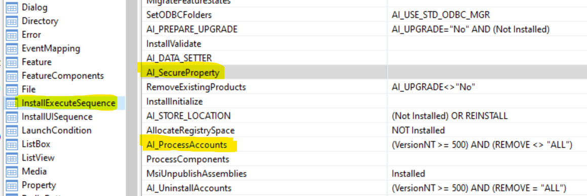

If you want to permanently get rid of this, you can edit the custom action's sequence in the "Table Editor" page, so the "AI_SecureProperty" action executes after the "AI_ProcessAccounts" action.

It seems odd to move the securing of the property data to later and risk exposer, but fine, hopefully we shall remember to do that in any future builds, but more importantly, is moving it below the AI_ProcessAccounts sufficient, given we also use it the custom action dll execution? Otherwise I could see the user being setup now with the correct and specified password, yet the one being passed to the dll being the new incorrect and mutated pwd value.
If you are using this property in your custom action as well, you might want to do the encyrption after the custom action is executed, so it doesn't take the encrypted value.
