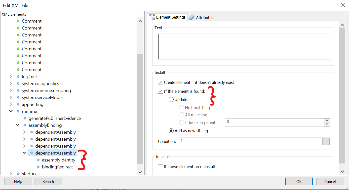

Re: XML File Runtime Element Placed Incorrectly
Hello Collins,
Thank you very much for the provided resources.
I have tested this on my end and I was indeed able to reproduce the behavior.
After further investigations, I believe I found the culprit.
The last element you have added to the XML file had the following option enabled for it: "If the element is found" --> "Update"
Basically, during the update, the setup will find the first "dependentAssembly" element, which in our case is:
<dependentAssembly>
<assemblyIdentity name="Microsoft.Owin" publicKeyToken="31bf3856ad364e35" culture="neutral" />
<bindingRedirect oldVersion="0.0.0.0-3.0.0.0" newVersion="3.0.0.0" />
</dependentAssembly>
and update it, resulting in:
<dependentAssembly>
<assemblyIdentity name="System.Threading.Tasks.Extensions" publicKeyToken="cc7b13ffcd2ddd51" culture="neutral" />
<bindingRedirect oldVersion="0.0.0.0-4.2.0.1" newVersion="4.2.0.1" />
To avoid this, please use the following option instead: "If the element is found" --> "Add a new sibling" (as in my screenshot above)
This way, the element should be added as a separate one, as you desire:

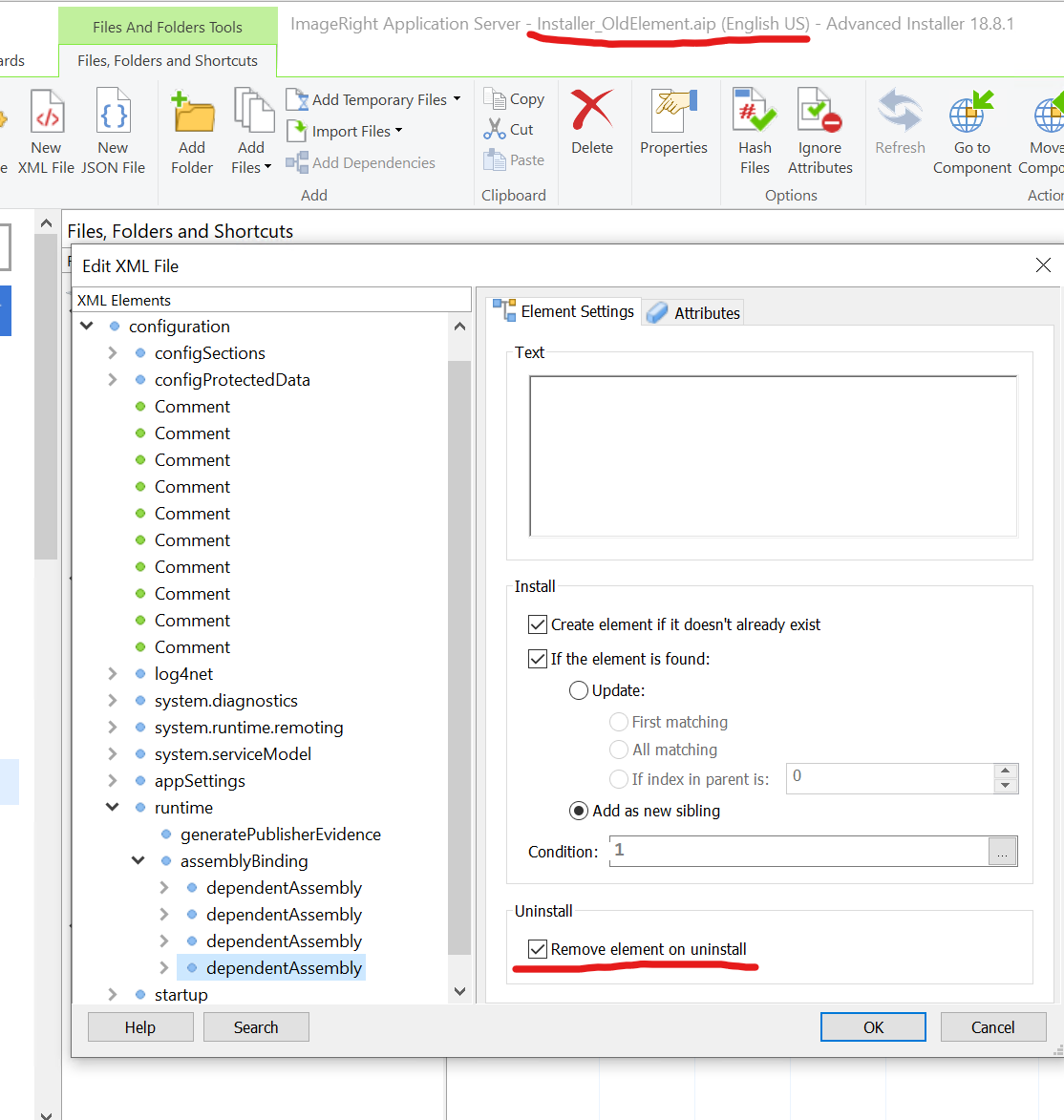

Please note that this is the correct behavior.
If your older setup already creates that element, you should set the "Remove element on uninstall" option for it.
This way, on upgrade, the element will be removed and it will no longer be duplicated.
Also, if the bindingRedirect version changes in the future, it would not get updated, correct?
If the behavior is not set to "If the element is found --> Update" then the answer is no, the element should not be updated.
First of all, please note that I did not receive any log files via the email. Could you please double check the email address?
Anyhow, the log files are not necessary here.
Later edit: Please disregard the above as I found the email.
I'm still seeing the same issue on upgrades as well
Could you please give me some more details about this?
Do you mean that the element is duplicated on upgrade?
Did you do the changes I mentioned in the older version of the setup? if so, this should be working as expected since I tested this using the two sample projects you previously provided. Basically, this is what I did:
- in the older version, copied the XML element that is also created during the newer version installation
- check the "Remove element on uninstall" option
- installed the setup
- built the newer project and installed it
I then checked the file and the element was not duplicated.
I have also tested this without the option and I could indeed notice the behavior you described.
Perhaps I misunderstood your scenario. If that is the case, please forward me a step-by-step test case which I can follow in order to reproduce the issue.
Catalin wrote: ↑Thu Nov 18, 2021 10:44 am
Yes, it was duplicated on the upgrade.
Yes, I set the dependentAssembly, assemblyIdentity and bindingRedirect to use "Add as new sibling" and "Remove element on uninstall" for the installed version and the upgraded version projects. I've attached the project just the way I tested them.
Going from v1 to v2 created this:

Installer_NewElementV2.aip
(257.53 KiB) Downloaded 1157 times
Installer_NewElementV1.aip
(257.53 KiB) Downloaded 1055 times

First of all, please accept my apologies for the delayed reply.
Thank you for the provided files.
I have managed to build them on my end and I was able to reproduce this behavior.
Considering your speecific scenario, I believe the only solution would be conditioning the installation of that node to only be installed if it doesn't already exist.
You can see whether the node already exists through either an XML search or a custom action.

Sorry for the late response, I have been on vacation. This seems like a workaround. Can this be fixed so that entire sections can be removed and added on upgrades? One of the main reasons we migrated and used XML config is for this capability and to easily upgrade these sections, but so far they have not worked as expected.

Regarding this, I do not believe this is a bug, but rather a corner case.
I will try to discuss this with the development team to see if we can somehow improve the behavior, but I do not see what we can do in this specific scenario.

Hi Catalin, I understand about the "Remove element on uninstall", but for the dependent assembly being placed under the wrong section, that is a bug because none of the other depended assemblies do that nor do I have to add them as a new sibling, which creates duplicates on upgrade.
Also, there is no way to condition those elements without having to use a custom action to resolve what should be working. We have other applications with runtime sections that have more than double the dependent assemblies and they don't have this issue.
Having the "Remove element on uninstall" outside of the component requirement would be a huge improvement.

Hello Les,
Please allow me some more time to further discuss this with the development team and I will followup on this thread as soon as I will have a conclusive answer.
Hello Les,
I further tested this last Friday, but unfortunately I wasn't able to obtain the desired behavior.
I created a ticket so the dev team can further investigate this.
I will followup on this thread as soon as I will have more information.
