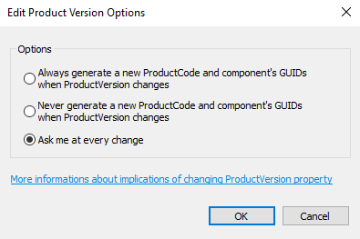

We have the project set up to pull the version automatically from our exe file. While confirming this info, I noticed the options button next to the Version field in the Product Detail page. Is that the new option that was added in 20.7.0? The value that was set for our project is "Never generate a new ProductCode and component's GUIDs when ProductVersion changes". I will be changing that to "Always generate a new ProductCode..." and I think that should get us back to how it was before.
Really good catch here! :)
We have indeed added that option to prevent the automatic generation of ProductCode for customers who wanted to create patches - because a patch requires the same ProductCode.
After changing that behavior, we should indeed go back to how things were.

Just opening the *.aip file and saving it again without even touching this option changes the <option> value in the .aip file from "16" to "24".
This is apparently the new value for the option to "never change" the product code.
This is IMHO a bug as you can't just change the behavior for everyone like that and the default should simply be the option that was default until 20.7.
As I understand it, everyone has to now proactively change this option to "always change" just to get back to the status quo?
Which value should <options> have if I do not want to change my AIs behavior at all after the upgrade?

For now, yes, the option should be set using the "Options" hyperlink from the "Product Details" page.
