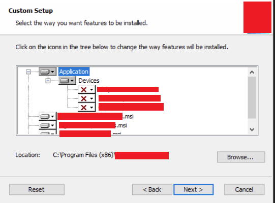

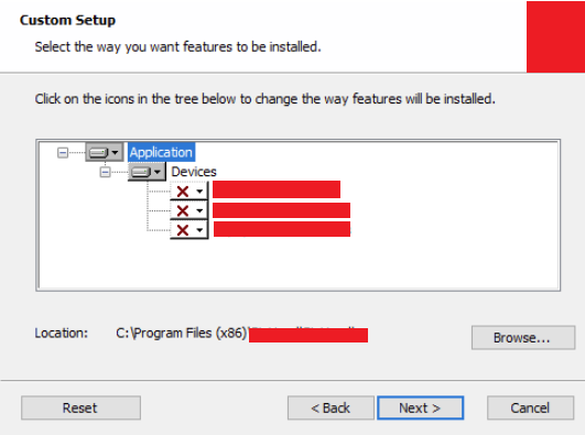

There seems to be a problem which has been introduced since an upgrade from 20.8 to 20.9.1. Within the Organization -> Features and Components section, we used to have the Features defined at the top:

...but now I can also see them defined at the bottom as well:
Features at bottom.png (12.51 KiB) Viewed 12644 times
This results in a duplication of the options when running the installer. Is there any idea when this can get fixed up?

This is to clarify the issue in more detail.
Back when we were using 20.8, AI would create an installer which ended up giving the user a choice of features to install:
But after an upgrade to 20.9 and then 20.9.1 the choice presented to the user gets mangled to this:
...with the feature options becoming duplicated below.

After looking at what the problem may be, I noticed that the change appears to be related to the Organization -> Features and Components section.
Back in 20.8 AI would show this section as below:
But looking at this same page in 20.9 looks the same at the top, but also shows the .msi files duplicated at the bottom:
So I'm not sure what happened between 20.8 and 20.9 but it looks like its messed up my usage of the Features and Components.

Re: Upgrade to 20.9.1 issue
This has been fixed in version 21.2 of Advanced Installer.
