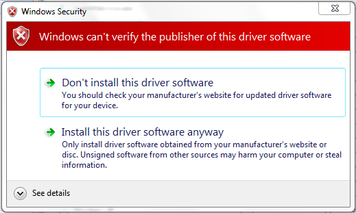

During the install (on two different windows 7 machines)... I get the following dialog:

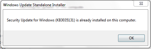

I checked an older post viewtopic.php?f=5&t=34303&start=15 about something similar and it indicated that for Windows 7 machines SHA256 driver signing is not supported unless KB3033929 and/or 3035131 have been installed:
BOTH KB articles have been installed on BOTH machines:
and

I've tested your driver installation and replicated the behavior. It seems that our Driver feature (which makes use of standard Windows Installer support for drivers install ) is not compatible with your kernel mode driver. What I discovered was that your driver is indeed installed but only partial: its binaries are installed but the driver service is not installed at all. I've tried troubleshooting this but unfortunately didn't find anything useful.
My assumption is that the standard Windows Installer support for drivers do not support drivers signed with a SHA256 certificate, thus the driver service fails to install due to an invalid signature. Probably this is why you get the "Windows can't verify the publisher of this driver software" error during installation.

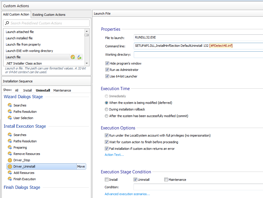

Here are my settings:
When I uninstall my program I get this:

Re: Driver install fails when using .inf file
Hello Mike,
It seems this happened because you scheduled your driver stop and uninstall custom actions before the "Remove Resources" action group. Can you please move (drag and drop) the above actions before the "Remove Resources" action group and rebuild and test this again?

I don't understand your post.
I downloaded the example I uploaded to you (in the post directly above your reply), opened it up and here is where the "driver_stop" and "driver_uninstall" are located???
