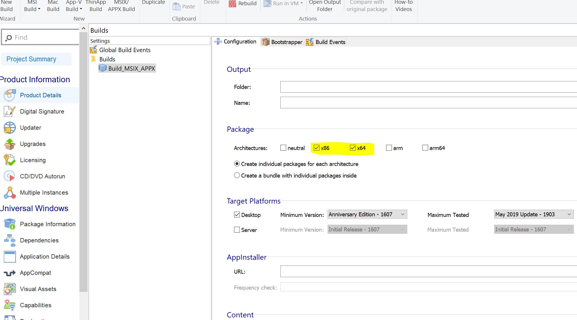

Until then, I would recommend you building separate APPX packages for each of target system architectures (e.g. x86 and x64) and then in "Organization" page create 2 new features (e.g. FeatureX64 and FeatureX86) and move all of your x86 file components under the x86 feature and all of your x64 file components under x64 feature. Then the FeatureX64 and FeatureX86 features must be configured to be included only in the x86, respectively x64 version of your APPX.
Hope this helped.
Re: File "C:\Program Files (x86)\Caphyon\Advanced Installer 16.1\stubs\res\emptyresdll.dll" could not be read.

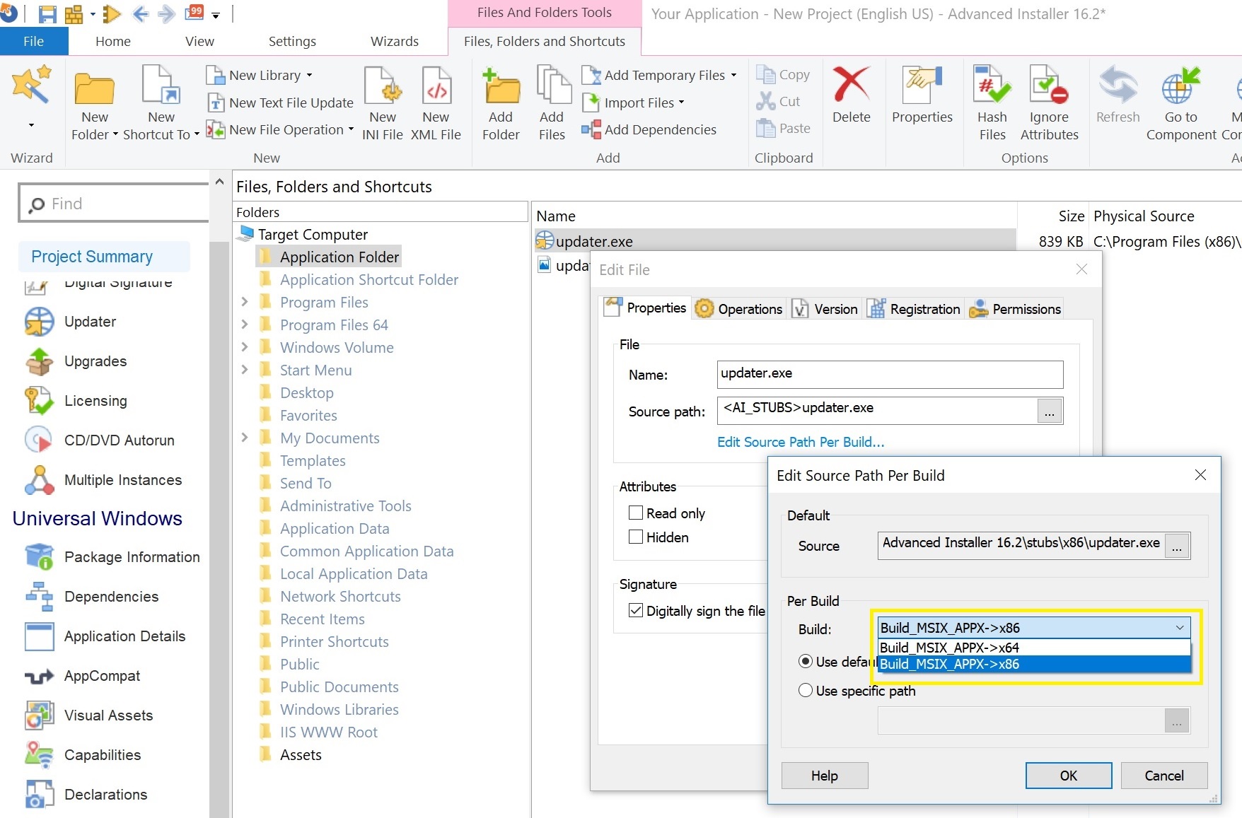

Also, as an additional solution, if you needs to include both flavors (32 and 64-bit) of a file into a single APPX/MSIX bundle build that can target multiple architectures, see the attached screenshot
then you should go to "Files and Folders" page, double click on your file and use the "Edit Source Path Per Build" hyperlink. Now in "Edit Source Path Per Build" dialog select in turn the "-> x86" and "->x64" flavors of your APPX/MSIX bundle build and configure their file source path.
Hope this helped too.
