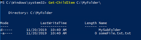

For instance, if the folder is already on the disk and you want to remove it during the installation of your package, you can use a script (e.g. PowerShell, VBScript, etc) that can search for it and remove its content. For instance, if we have the following folder on the machine:
C:\
--->MyFolder
------>MySubFolder
------>someFile.txt
a simple PowerShell script which will delete the content of the folder, except the subfolder would be:
Get-ChildItem C:\MyFolder -Exclude MySubFolder | Remove-Item -Recurse -Force
Basically, the Get-ChildItem will get the content of the "MyFolder" folder:
The "-Exclude" parameter is used to exclude our folder from it:
