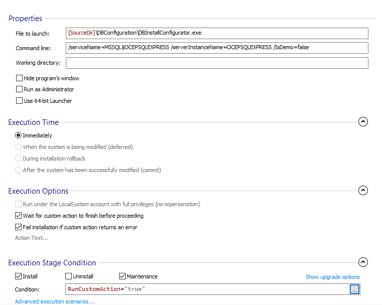

i tryed this, but i cant make it work. In Builds, Package Type is Exe with resources next to it
In install parameters, there is Property "RunCustomAction" = "true"
Custom action has condition RunCustomAction="true"
But when I run Setup.exe RunCustomAction="false", that custom action still run.
I dont know what is wrong.
Posts: 4971
Re: Install parameters from commandline
Please keep in mind that a private property (which name contains lowercase letters) cannot pass its changed value from the UI stage to the Install stage. So, the new value that you set for it from command line will not be passed to the Install Execution stage. In order to achieve this, you need to use a public property which name contains only uppercase letters (i.e. RUNCUSTOMACTION).
