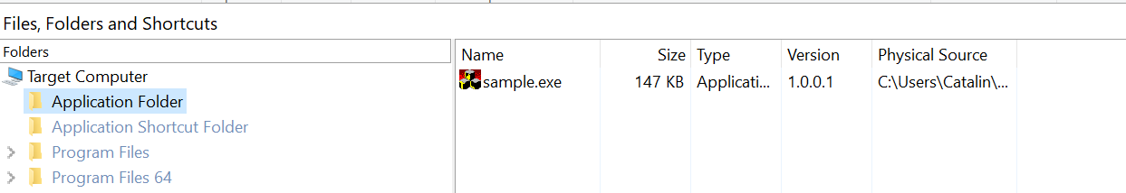

- first, we will need to add an executable to our project (so we have a base file for our shortcut)
The file should be added in the "Files and Folders" page.

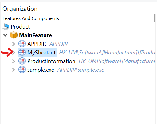

- now, we will need to create a component for this shortcut (so we can install it as a separate entity of the executable itself). To do so, please go to "Registry" page and create a new registry entry, i.e.:
For the above registry entry, a new component will be created in the "Organization" page.
In this component, we will need to add the resource of the earlier created shortcut. In the end, it should look something similar to this:
As you can see, we have already conditioned the installation of this component based on a WIndows Installer property. This property will then be further assigned to a UI control in our main package.

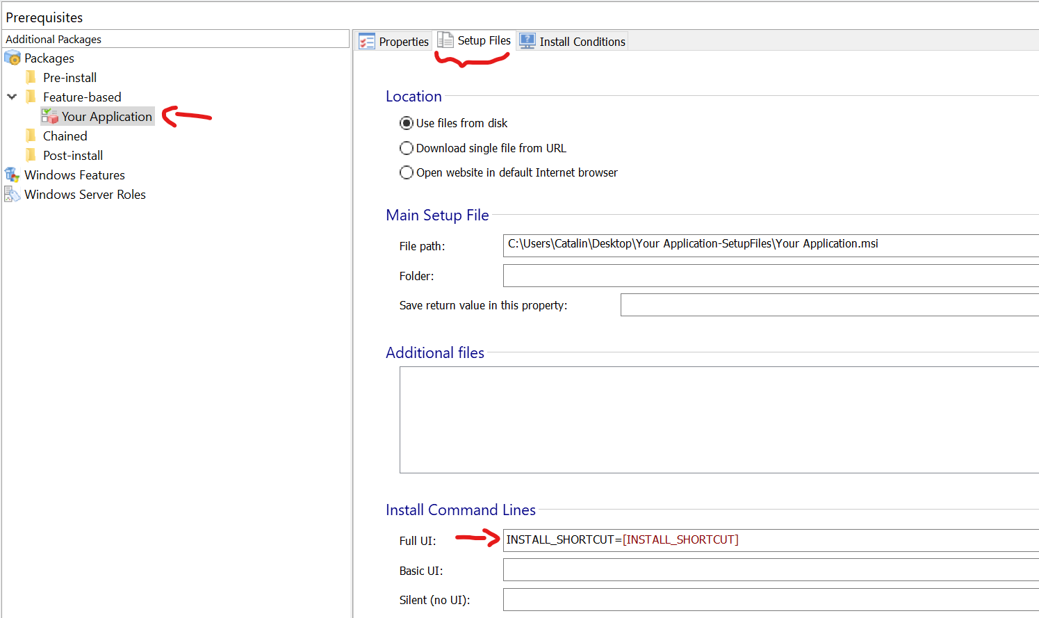

- now, we are pretty much done with the prerequisite package. We will need to move to our main package now. Please open the AIP file for the main project and go to "Dialogs" page. Here, we will create a new dialog and a checkbox which will decide whether the component (the shortcut) in our prerequisite package will be installed or not.
As you can see, we have added in our dialog a new "Checkbox" control. We have assigned to it the same property name as the one from our prerequisite package and the default value (when the checkbox is checked) of "Yes".
- now, we will need to go to "Prerequisites" page and if you did not add the package already, please add it as a "feature-based" prerequisite. Additionally, in the "Setup Files" tab of the prerequisite, we will pass the INSTALL_SHORTCUT property to our prerequisite.
As you can see, we have passed the property over to the prerequisite. I have explained it in my previous thread, but here is what will happen behind:
main package is launched ==> the user will have the checkbox checked ==> the value of the INSTALL_SHORTCUT property will be set to "Yes" ==> the prerequisite will be launched with a command line such as follows: msiexec.exe /i <path_to_MSI> INSTALL_SHORTCUT=[INSTALL_SHORTCUT] ==> the above command line will set, inside the prerequisite, a property named INSTALL_SHORTCUT and it will set it to the value of the INSTALL_SHORTCUT property from our main package ("Yes") ==> when the evaluation of the components will be done, the prerequisite package will evaluate the condition, it will see that the INSTALL_SHORTCUT property is equal to "Yes" ==> will perform the installation of the component ==> the shortcut will be installed.
