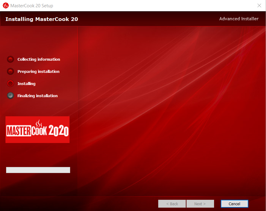

Thank you for your reply. After I run the upgrade installer the installer is stuck at this point: See attachment image. Have to kill the task from the task manager to exit this window. The cancel button does not cancel the installation.
Also, attached is the verbose log file for your reference. Let me know if you need any more details from my side.

The installation seems to hang during the preservation of the user files. Since the "Do not overwrite existing files" option is set on the user folder, that folder is backed up at the beginning of the upgrade and restored at the end. However, the backup seems to hang in your scenario.
Is the size of that folder very large? Did it hang for a very long time? Are you sure that you have enough space on the external HDD, so the files can be backed up on it?
