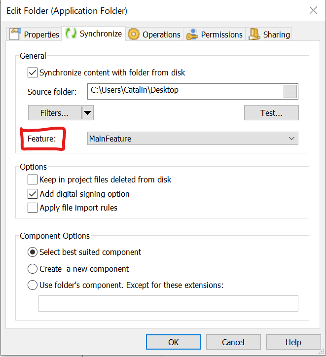

Re: Synchronized folder
Hi Shlomi,
I checked the project that you sent and I found that the "Database Updater" folder is synchronized to the "MainFeature" feature, hence the new files added to that folder will be added to that features (see the image below). Can you please change that to the desired feature and test it again?

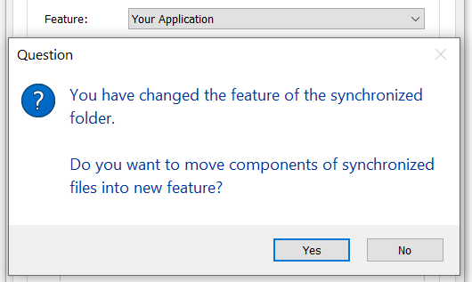

Posts: 4971
When you change the feature for a synchronized folder you are asked if you want to move all the existing resources to that feature (see image below). Please make sure that you select "Yes" and all the files should be moved there.

berqo127
Posts: 21
Joined: Tue Aug 06, 2019 1:35 pm
HI,
In my case I don't get the message you mentioned. anyhow it seems that it doesn't matter what Feature I set part of the resources are set to Main Feature and the others to Database Updater.
