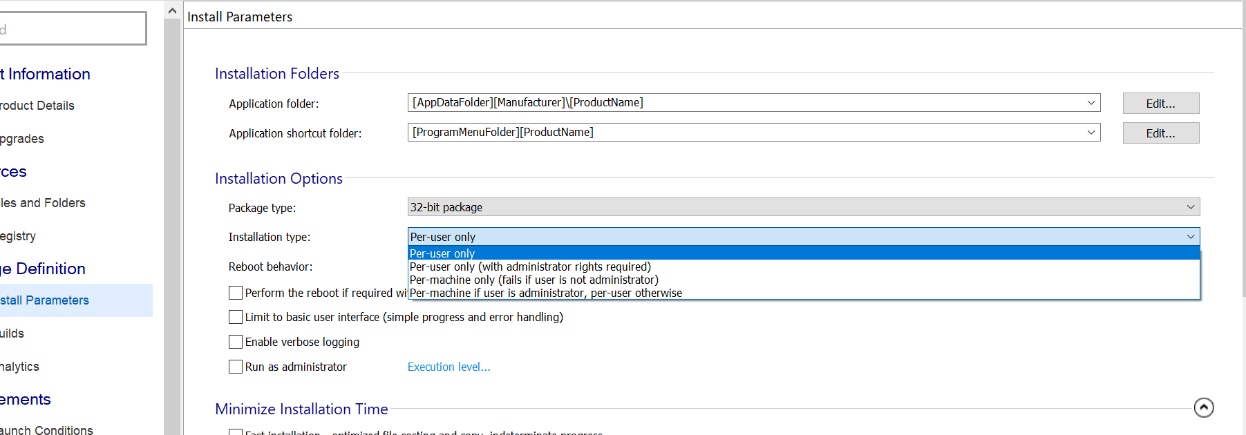

I am currently using a trial version of advanced installer. I've created a professional installer project. From the list of available install type options:
I have selected the last option:
selected option.PNG (21.51 KiB) Viewed 22494 times
In the documentation, it says that we need to select InstallTypeDlg in order for this option to work. https://www.advancedinstaller.com/user- ... eters.html

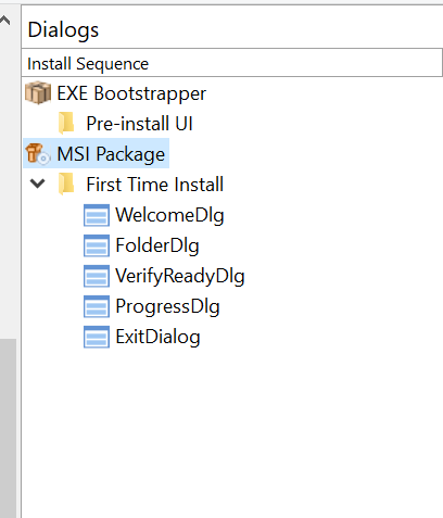

However, this dialog is not present in dialogs page.
dialog list.PNG (13.66 KiB) Viewed 22494 times

InstallTypeDlg is not present in my list of pre-defined dialogs as shown in the screenshot posted by me above.
Re: Not able to use "Per-machine if the user is an administrator, per-user otherwise" install type
Indeed, this dialog is not automatically added. You need to add it from the predefined list of dialogs. Use the Add Dialog option as you can see in my printscreen.
