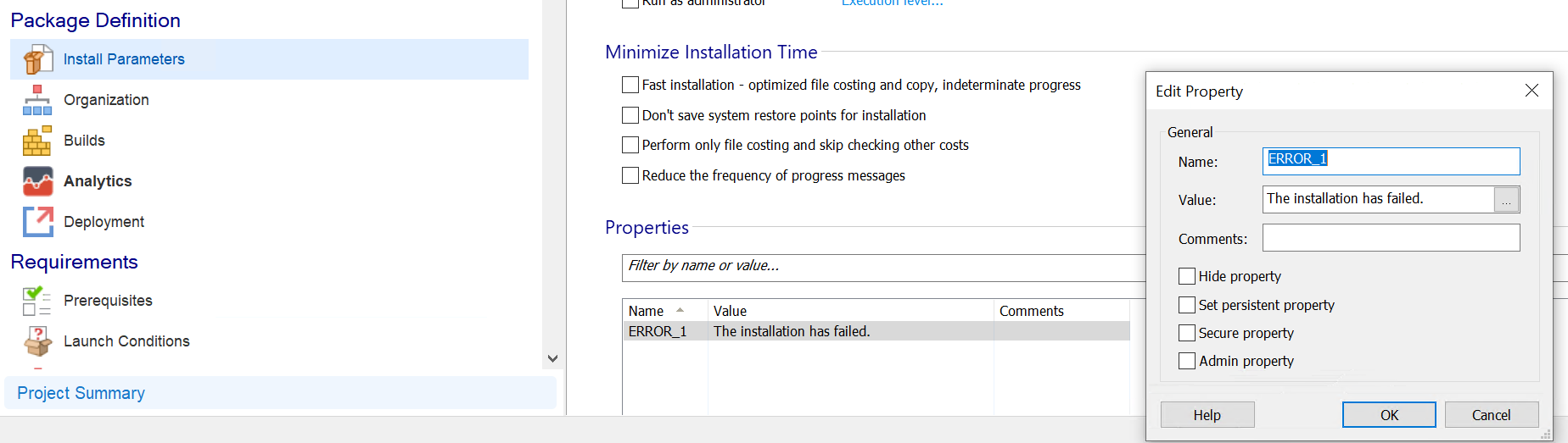

- e.g. of property that stores the message:
- e.g. of "Text file update":

Yes, I have stored them as installer properties. Also, I have used a "Text file update" to write them to a .txt file. But this file creates only when the installation works fine. If the installer stops prematurely then the file isn't created.

You are indeed, right - the .TXT file will only be created if the installation is successful.
With this in mind, I'm afraid we can not really achieve this with our predefined support, since a "Text file update" operation is executed either on a component install or uninstall, therefore if the setup fails before that, it will not be executed.
You can create a .TXT file through the custom action and then write your custom messages to it (for instance, a PowerShell script).
