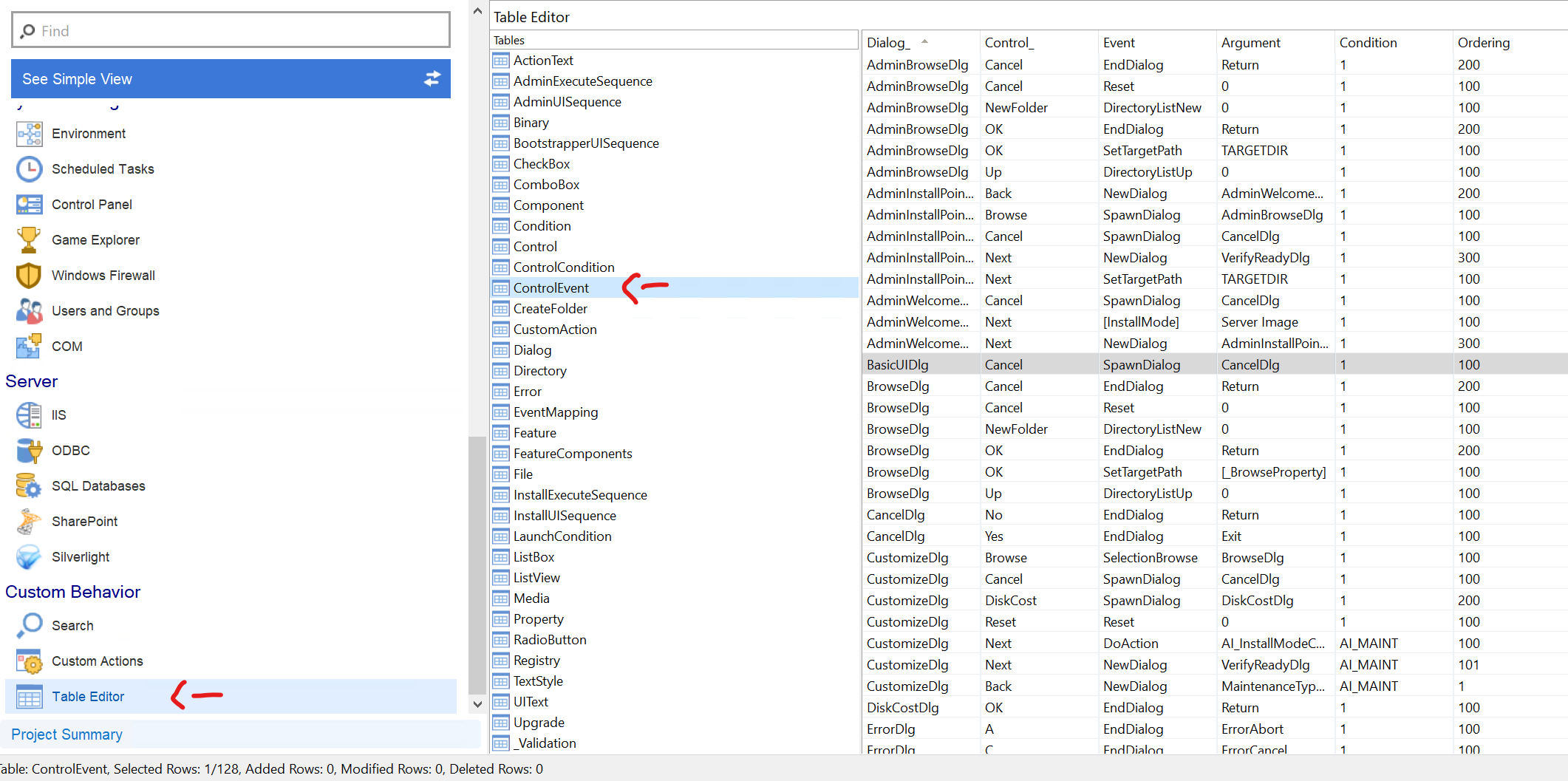

Re: Error calling MSI API: 1627 Method: MsiDatabaseImport Table: ControlEvent. Extended Error: 1: 2216
Hello Rob,
That error is usually thrown when there are duplicate controls in the specified table.
This can be seen by using the "Table Editor" feature --> "ControlEvent" table.

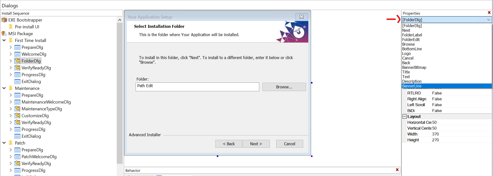

However, considering this specific scenario, since this refers to UI controls (dialog controls), it can also be seen in "Dialogs" page.
For instance, if "FolderDlg" would have a duplicate control, you would be able to find it here:
