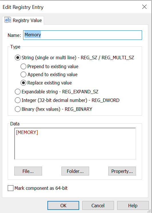

- in "Registry" page, we need to give the value to our node through the above property, e.g.:

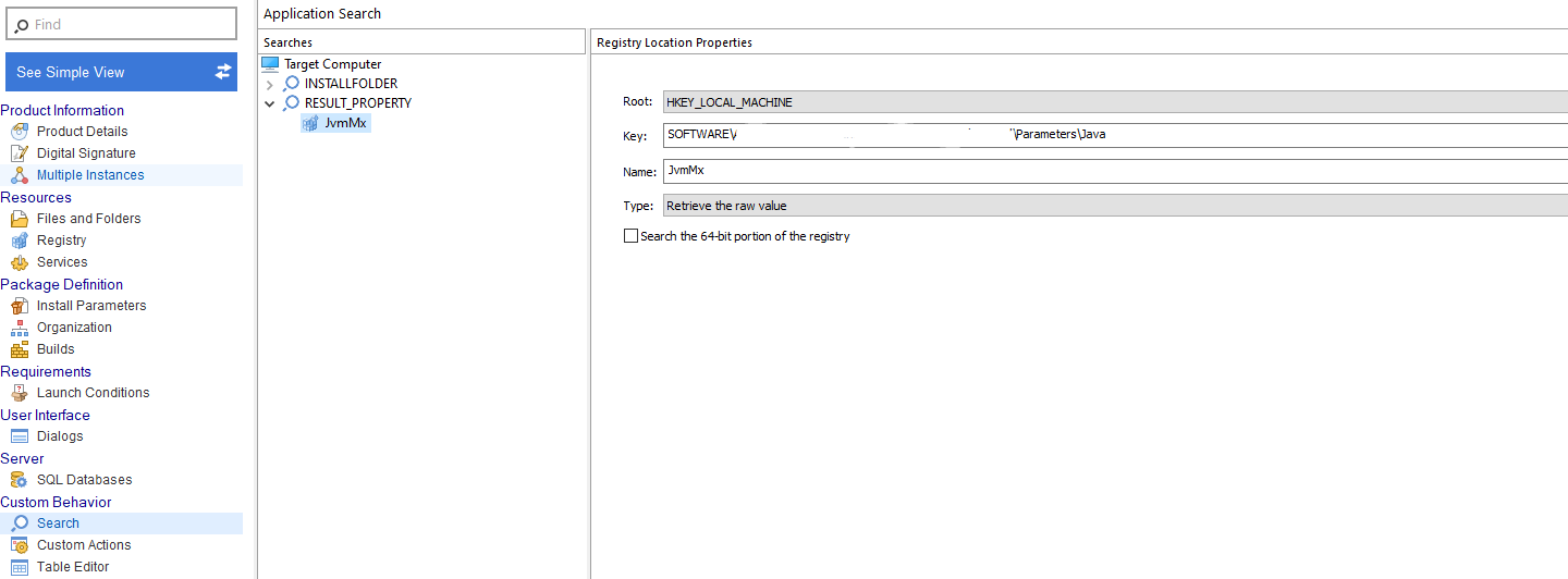

- create a registry search (in the "Search" page) that will retrieve the raw value from our node, e.g.:

The solution you've suggested works perfectly when I set the Registry Value to String > Replace existing value like in your example. However as I wrote in the initial question, my Registry Value is an Integer, not a String. For some odd reason it does not work when I set the Registry Value to Integer even though everything else is exactly how you showed me to do it.
So here is what I did:
1. I introduced a new property in my Install Parameters
2. In Registry I use the new property in the Data field og the Registry Value. Note that th type is Integer, not String
3. I created a Registry Search (in the "Search" page) that retrieves the raw value from the node

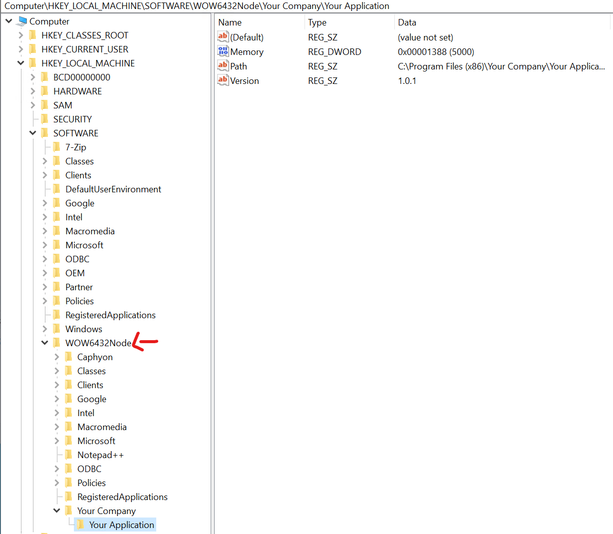

We need to take into consideration the bitness of our setup, though. For instance, on my 64-bit machine, the registry is actually written in the WOW6432Node because the process (the setup) is of 32-bit type.
This will be automatically handled if the setup is of 32-bit and the platform used for PowerShell is set to 32-bit.
