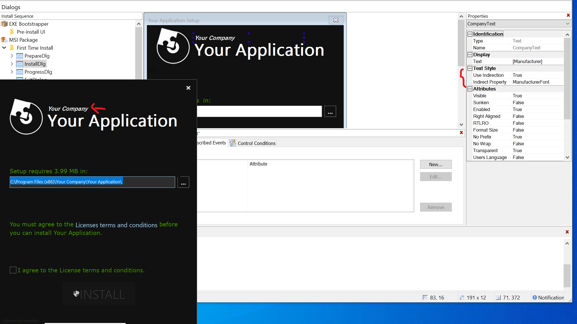

Hi Team,
I was trying to change some fonts for a project using the "Surface" theme.
For example, I edited the font "Manufacturer" (Property "ManufacturerFont").
However, these modifications only apply if I go to the Dialogs page, select the text field and then change "Use Indirection" to "false". As long as it is true, the changes won't apply.
This means for me that I have to go to every single install sequence page and change the text styles of every single text box for all changes to apply.
I guess, I am doing this wrong because that can't be the expected behavior.
Can you help me out?
Simon

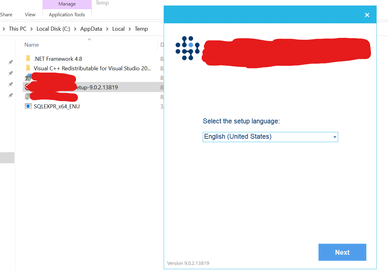

SimLoe
Posts: 69
Joined: Thu Mar 12, 2020 11:37 am
Re: Changing Fonts - "Use Indirection" option
Hello Catalin,
i will send you the AIP file of my project to have a look at it. In the meantime, I continued my research. It looks like if I use the "Test Installation UI" option, everything from the background perspective is rendering as expected. When I actually build the setup and run it, the colors of the "BrightCyanSurface" theme are not taken and the borders are black and the background of the dropdown etc. as well.
Left, you see how it looks using the "Test Installation UI" option, right you see the actual build (both done on the same machine).
It somehow looks like the internal background is gone missing (our selected background image is displayed correctly).
I was not able to reproduce the behavior with a sample project, but trying to do so, I found out that this bug is still active, because I encountered it as well: viewtopic.php?f=2&t=23602
Maybe this has something to do with it?
Please let me know if you need further information to fix this!
Simon

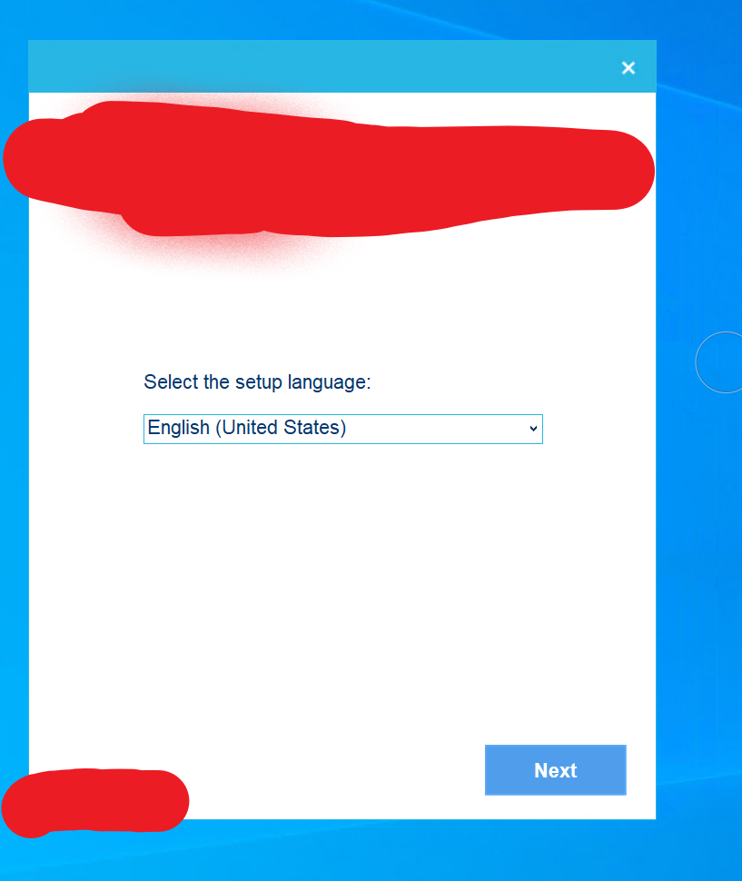

Hello Simon,
I was not feeling well yesterday, therefore I had to take the day off, thus the reply has been delayed a bit.
Regarding the issue, I have built the .AIP file you have provided using dummy resources and everything worked as expected on my end. Here is how the drop-down looks when launching the setup:
Could you please forward me a download link for the setup so I can test that as well?
Additionally, are you able to reproduce this on multiple machines, or is this issue specific to only one machine?
If it is the latter, could you please give me some more details about the display settings (the resolution & the DPI)?

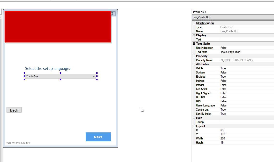

SimLoe
Posts: 69
Hello Catalin,
are you sure, you actually built the setup or used the "Test Installation UI" option?
I built the setup with different machines and used different machines for running the setup. The result is always the same: The background is black.
What are the technical differences between using the "Test Installation UI" option and the actual build? Is there something responsible for setting the background color?
Can we have a Teams meeting? I would like to show you how it looks here.
Is there an option I can use in order to change the background color of something like the drop down menus?
Simon

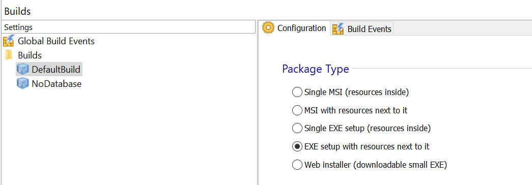

Hello Simon,
I am, yes.
As far as I am concerned, there shouldn't be any.
I believe I was able to find the culprit here.
First of all, there are two builds in your project:
For each build, you have a different theme:
- one has the BrightCyanSurface theme
- the other one (the NoDatabase one) has the BlackSurface theme
For both dialogs, on the "LanguageDlg" dialog, you have pointed to the same background, the white-background.jpg
Most likely, after building the setup, you are launching the "NoDatabase" build, resulting in the BlackSurface theme with the white background.
If you would have launched the build that has the BrightCyanSurface theme (the "DefaultBuild"), you should get the behavior you expect:
Most likely, when you have used the "Test installation UI" option, you have used it for the DefaultBuild build, while afterwards launching the NoDatabase build.
Hope this will help. :)
Hello Simon,
Regarding the font issue, after further discussing this with our development team, it looks like the behavior is normal.
The Manufacturer font is changed for variations using the Fallback support.
In order to change the font for white lets say, you need to change the ManufacturerGreen font (basically what the color is for it. In our case, for the WhiteSurface theme, it is green), e.g.:
This should result in the following when launching the setup:
