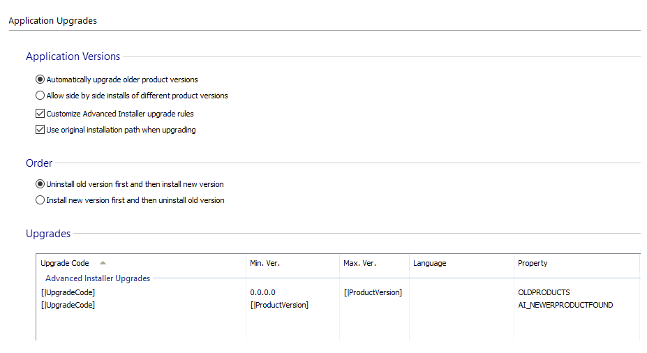

Before posting this topic, I tried to use "save as template", changed Product code and Upgrade code but nothing work. It only works when I change the version to 2.01. Please take a look at my setting on Upgrades page. Is there something wrong? Note that I'm using Advanced Installer 18.3.
Screenshot 2022-01-18 140719.png (22.22 KiB) Viewed 4096 times

I still cannot reproduce this on a sample project.
In order for us to further investigate this issue, can you please send us the following resources:
1. the .AIP (setup project) file for version 2.00
2. the .AIP (setup project) file for version 2.00.1
3. and an installation log of the upgrade process when the issue appears.
file by email to support at advancedinstaller dot com?
