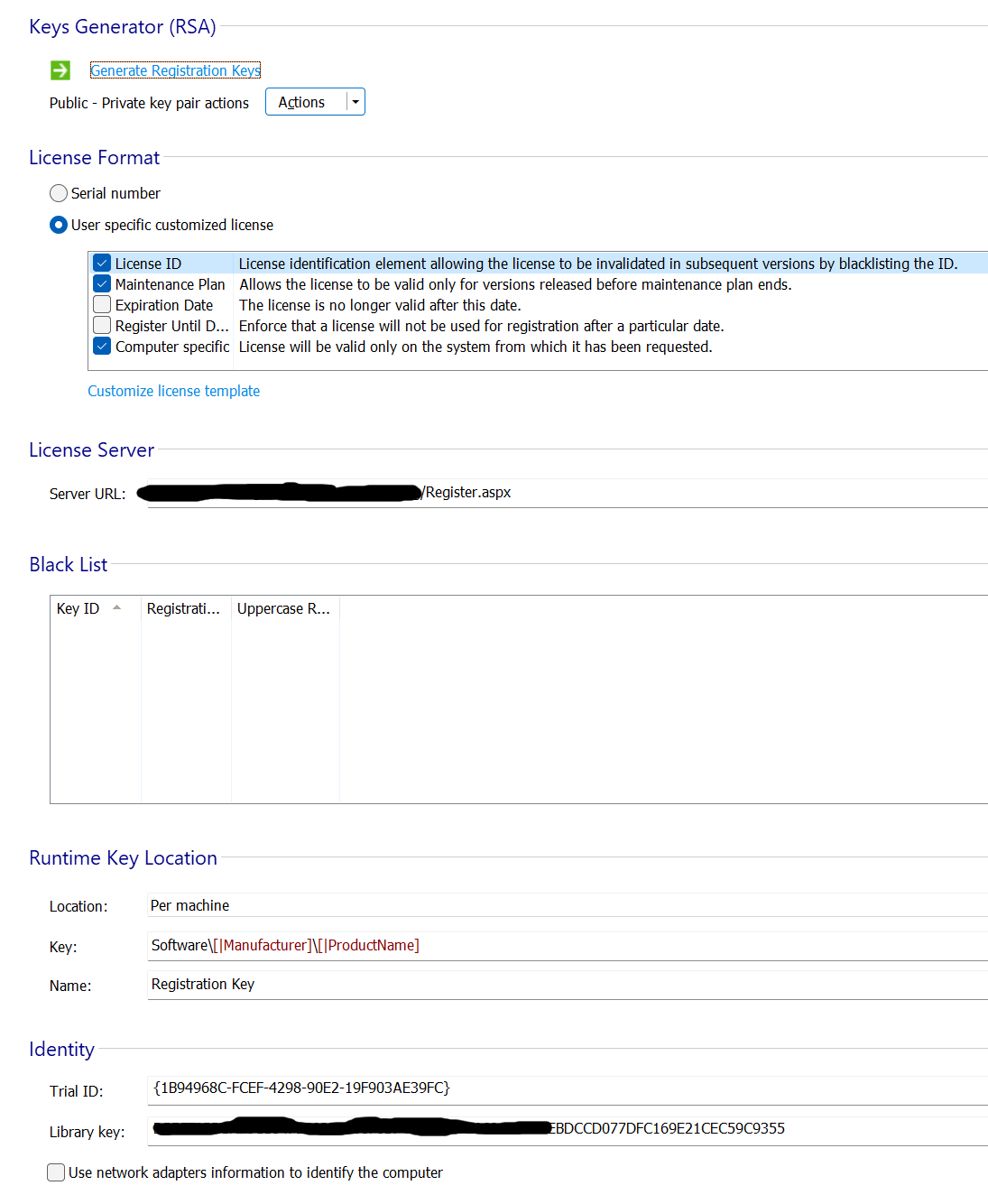

Hello. I have implemented the ASP.NET (C#) example of a license server for my application.
I have also confirmed that the communication channel from the AI registration dialog in my application and my license server is working.
However, the AI Registration dialog always returns "the registration key is invalid".

AI Registration settings

Re: License Server issue
I really cannot say why this happens. Maybe it has to do with the encoding you use when computing the digital signature or with an invisible character included in the license elements string/signature. Can you please make sure the license elements are merged into an UTF-16LE encoded string before being computed their digital signature?
Also, could you share with us your .AIP (setup project) file and a download link of your built setup package so we can fully test the scenario on our side? If so, just send us your .AIP file alongside a setup download link by email at support at advancedinstaller dot com. And also any test case we should follow to replicate the behavior.
If you cannot share with us your setup project file, then you can try to isolate the behavior in a buildable sample (.aip + its referenced files) which we can build and test on our side.
