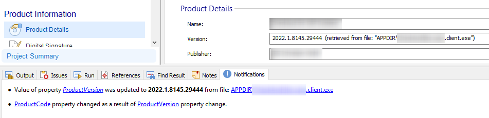

Having upgraded to 19.3 the AIP file remains unchanged after the build. When opening the project with the UI a message appears that the ProductVersion property has changed and the ProductCode has been changed.

The setup is configured to use the version number of the main EXE being installed (see screenshot above).
After the build the setup project always contained the version number of the current EXE and a new product ID.
There was no need to run any additional commands, such as "setversion". Has this been changed between 18.4 and 19.3? If so, how do we get back to the previous behavior?
